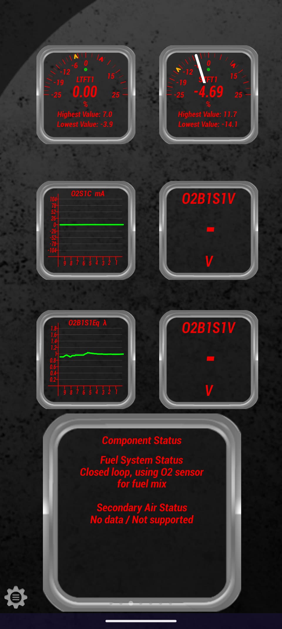

Have the torque app and ran car up to temp and took a blast locally and captured the below.
Top left is short term Fuel/air mix and top right is long term.
Other 4 widgets are showing sensor 1 voltages etc.
Any help or thoughts appreciated.

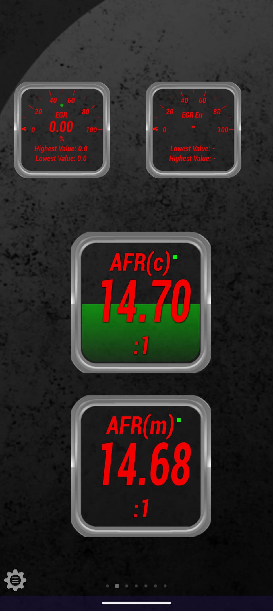

Whilst you have torque running - have a look at the AFR
Should generally be around 14:1
These are the reading I get when I run that just now. Not sure if it requires a full run out and up to max temps or not.

That is pretty healthy AFR - shouldn’t be running rich at that.
