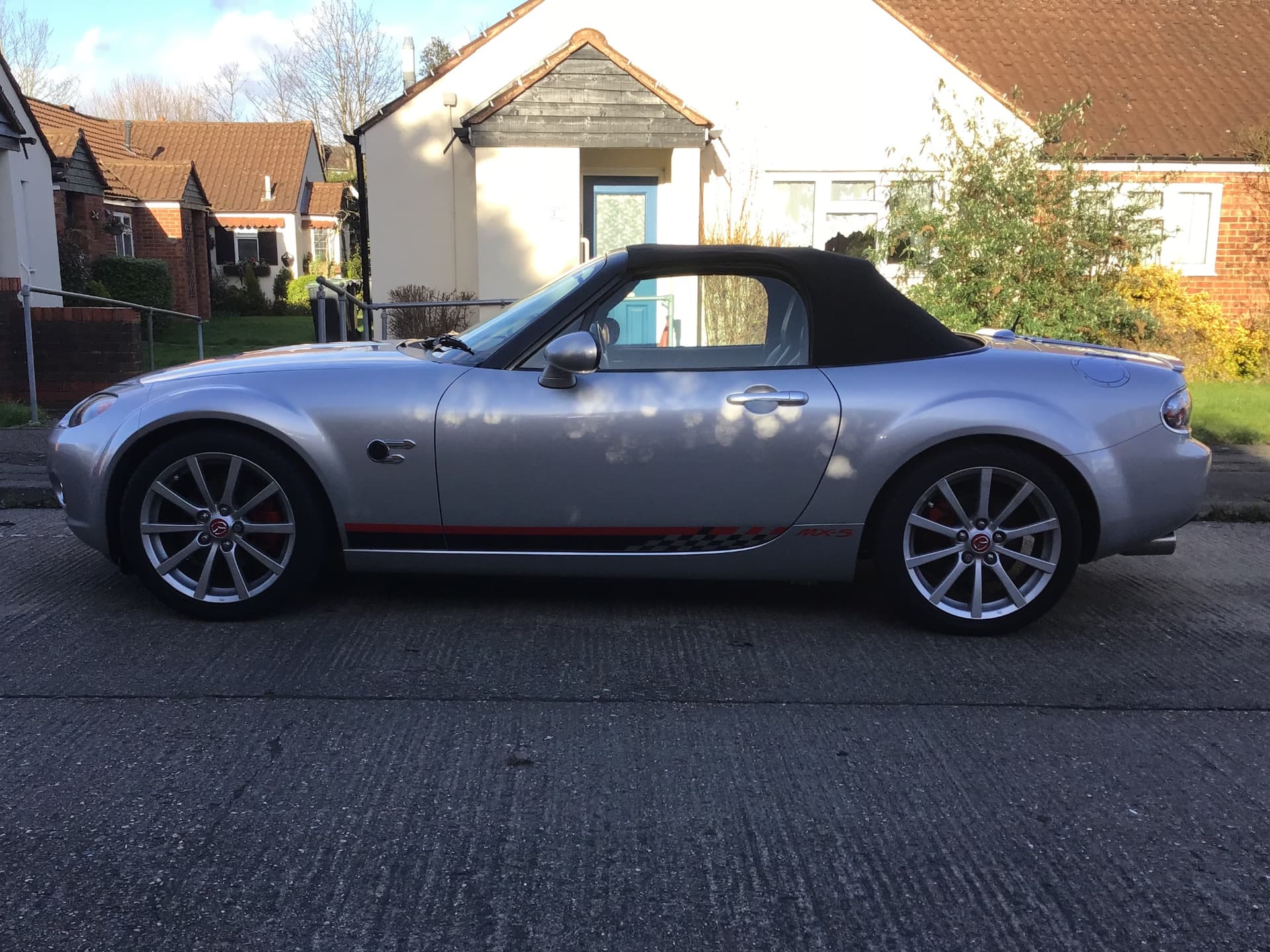

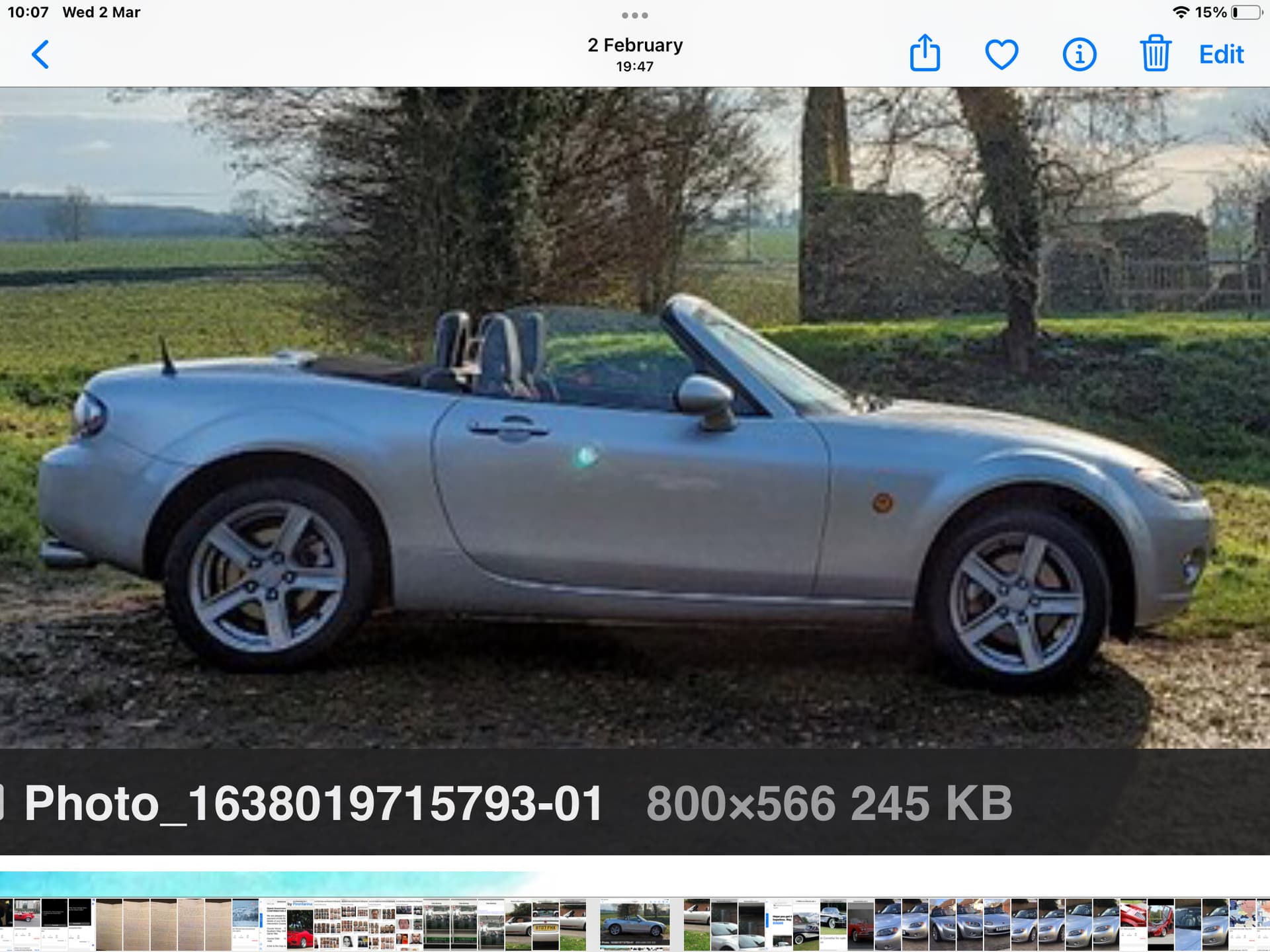

Sorry to interfere with the flurry of questions and answers here. But We are all trying to visualise your problem without being able to see the car and so it’s guess work, If your car is sitting lower on one side You may have broken a spring on hitting a serious ‘Pot Hole’ Etc, The ride hight is a bit high on a NC if it hasn’t been lowered on 30mm springs, They generally tend to sit “ too high “ on the Factory settings. But Don’t dismiss the other advice about a seized up anti roll bar component. It too is known to prevent the Car from sitting right if it is tightened too much Someone suggested Loosening the bolts and see if the car finds its correct level Etc. Good advice there !
Can you show a picture of your car ? Here’s one that is standard hight and one that has been lowered 30 MM
I get where you are coming from, but even seeing a picture would be guess work surely. :man_shrugging: :+1::slightly_smiling_face:
Hi, What I was hoping a photo would show up Is whether or not The problem was obvious to the naked eye, I appreciate that a photo could do no more than to show the extent of any abnormality Only that an ‘abnormality’ exists, Etc, Best regards from Ray in Essex…
