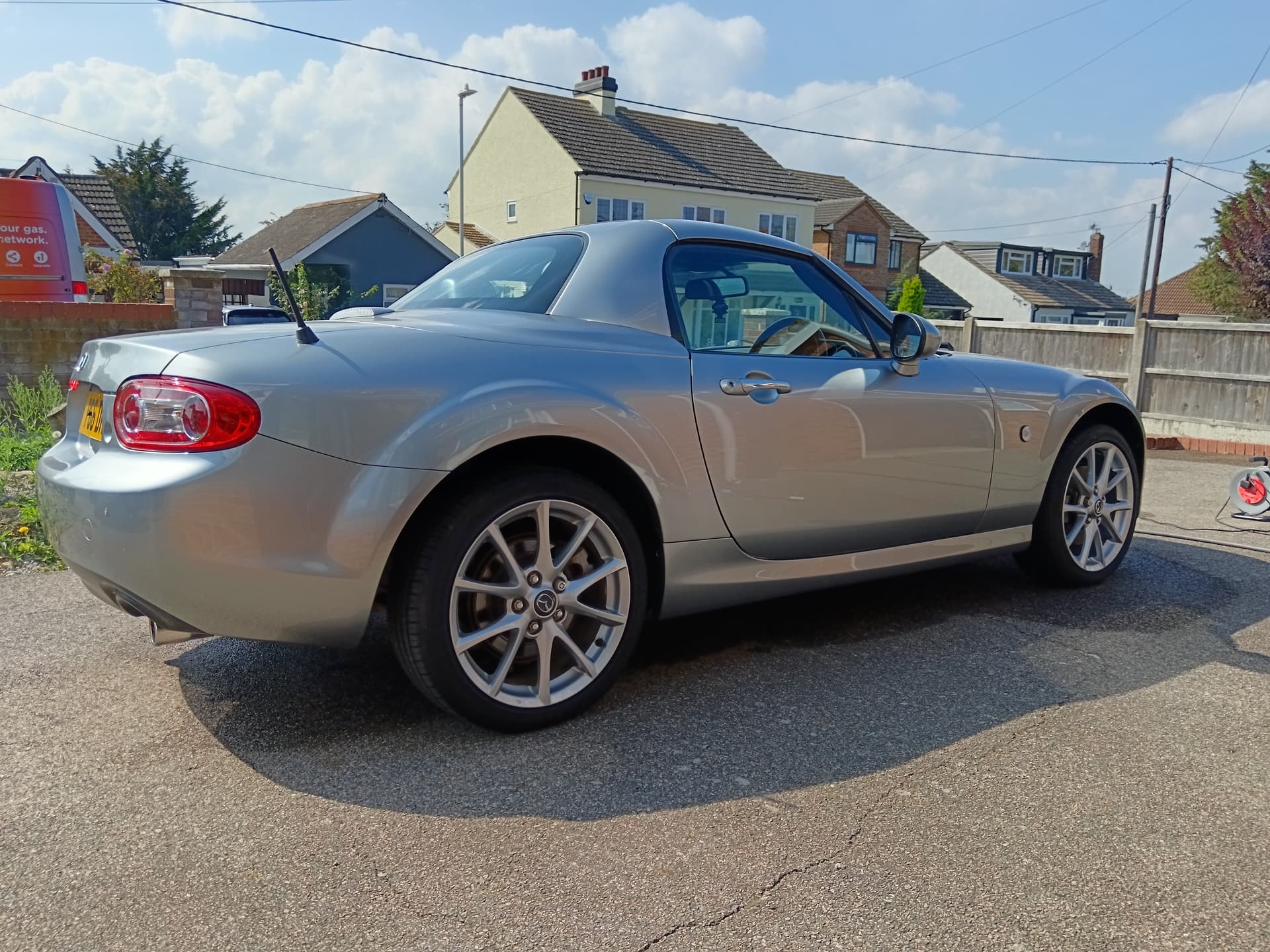

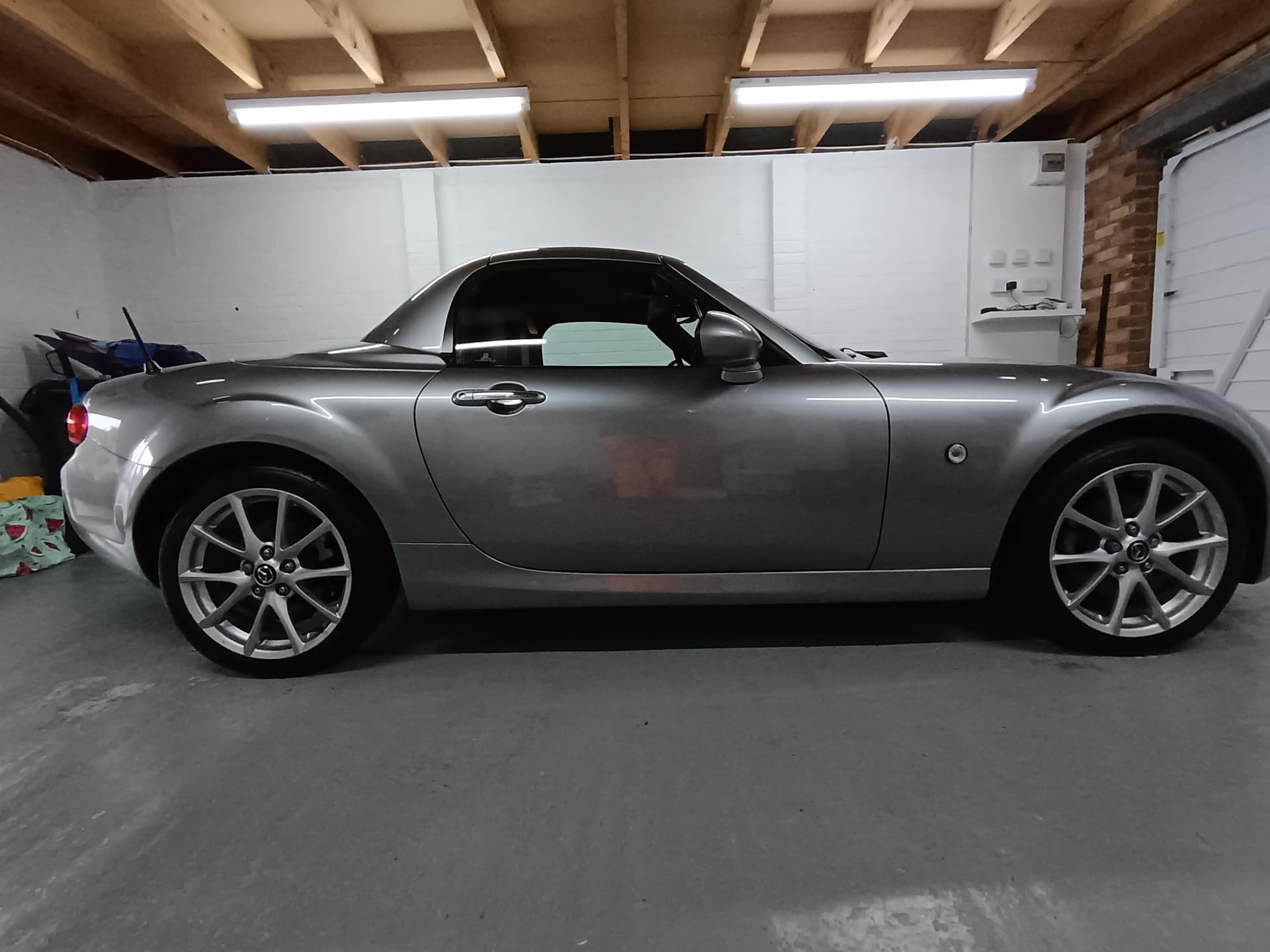

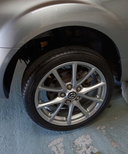

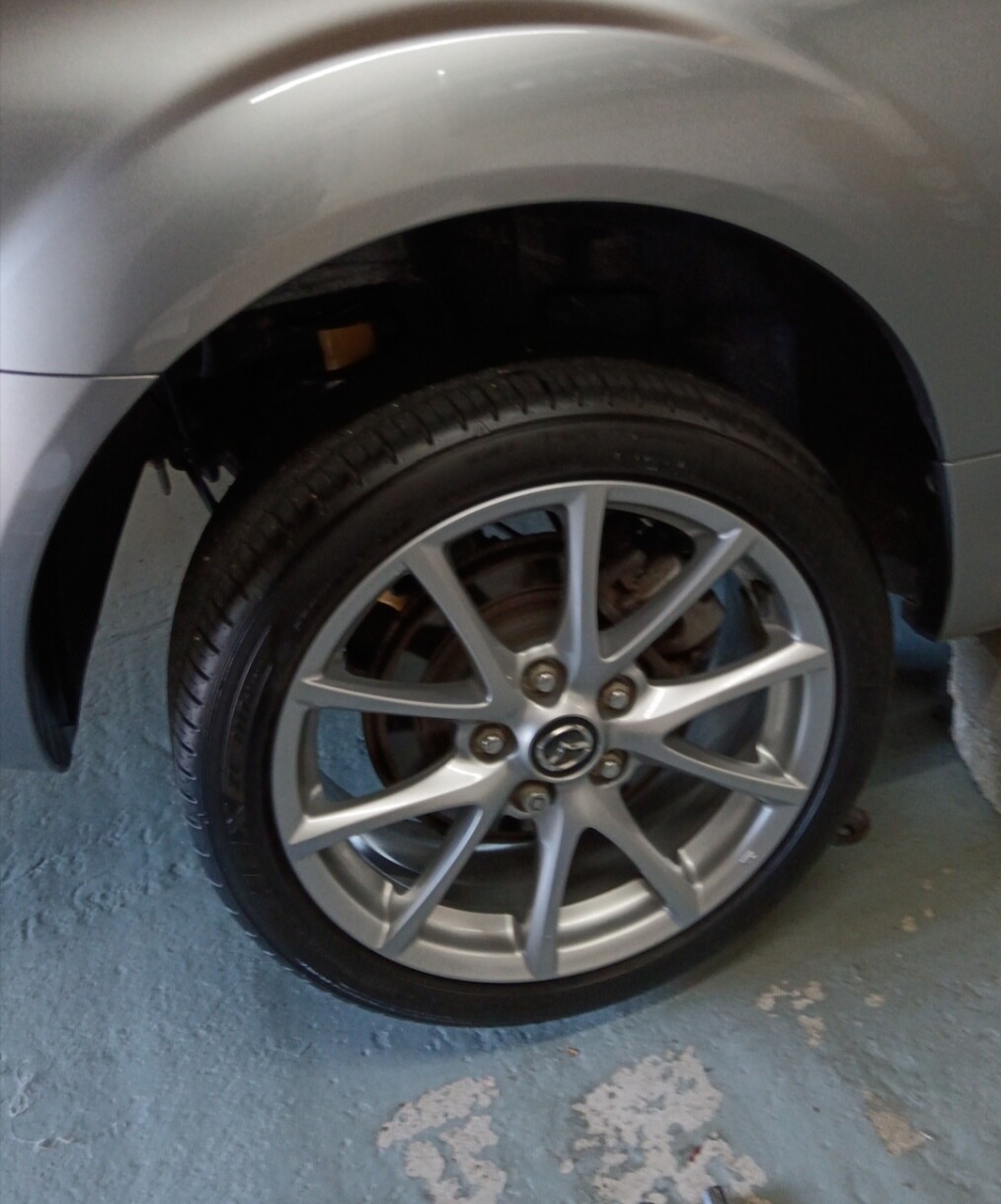

Hi all, looking for some advice, I am trying to sort out the ride height on my 2009 Mk3.5 Sport Tech PRHT. I recently had new front arms fitted as all the bushes were perished. Also a refurbed front subframe was fitted at the same time. As a result of all this work the front ride height is now significantly higher than before the work was done. The rear suspension is markedly lower though, 34 cm from wheel centre to underside of wheel arch, compared to 38cm at the front. I wondered if the rear springs were sagging causing it to squat at the back, however I remembered the car had a replacement n/s/r spring in 2022 and the rear height is equal both sides, so is unlikely. All the suspension is stock. I’ve been thinking about adjustable coilovers to try and rectify the problem but as most of them available will be lower than standard even on their highest setting, and with it already fairly low at the back I might run into problems with the back sitting way too low. Could it be the rear trailing arms that have caused the back to sag, and if so which of them are to blame? Or is it something else like maybe worn dampers? The car is not bottoming out, and the handling seems ok, it just looks all wrong from the side view (see pic). Any thoughts would be welcome, thanks!

In my opinion having seen plenty of these cars (no way an expert on suspension) your car appears lowered at the rear but looks like a standard height Sport Tech should be at the front.

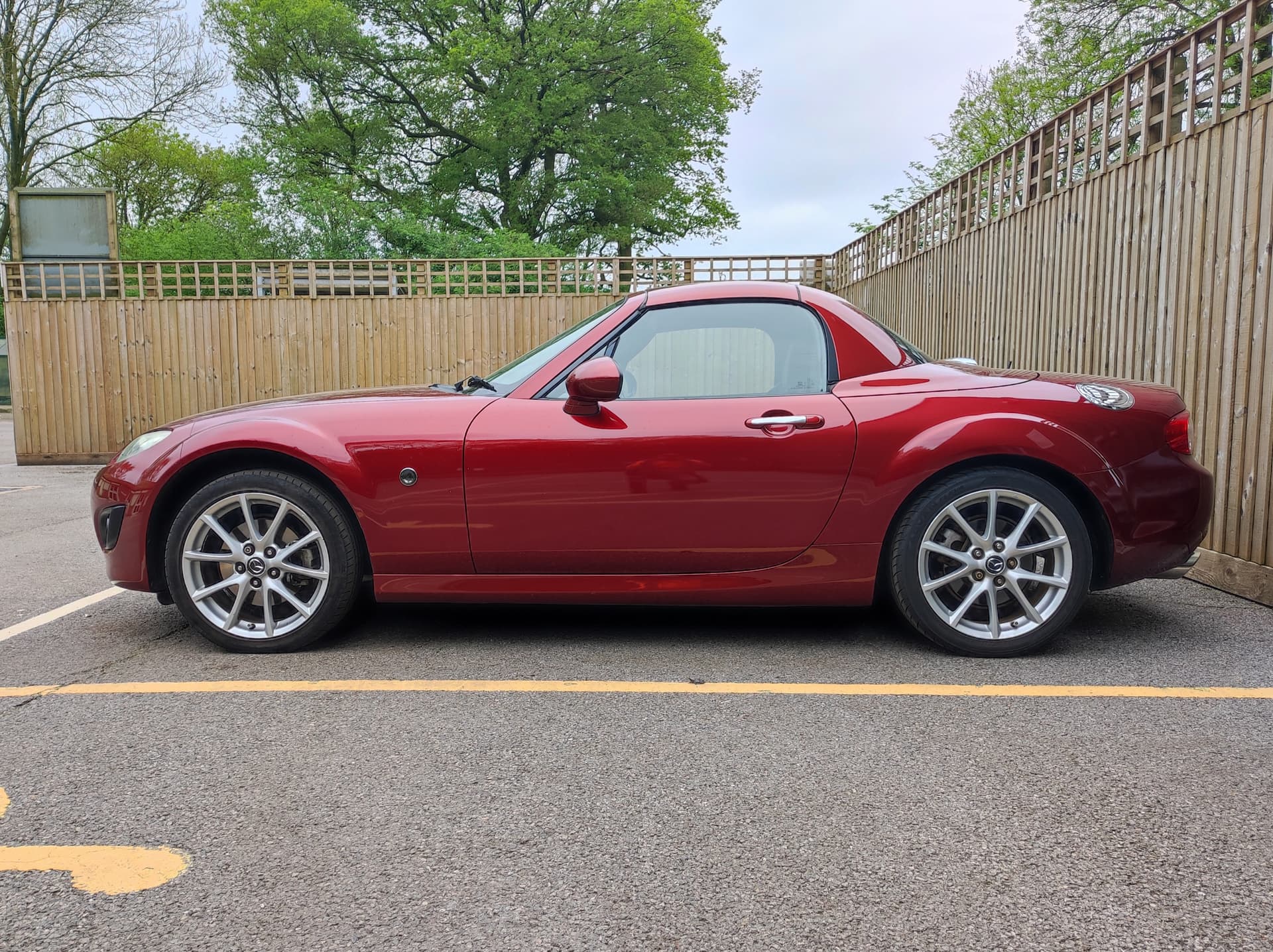

I have a side on pic of my car when it was dead standard and on low mileage shocks and springs if you’d like a reference. Even the sport techs sit a little high in my opinion but the earlier cars seem even higher.

Here you go.
