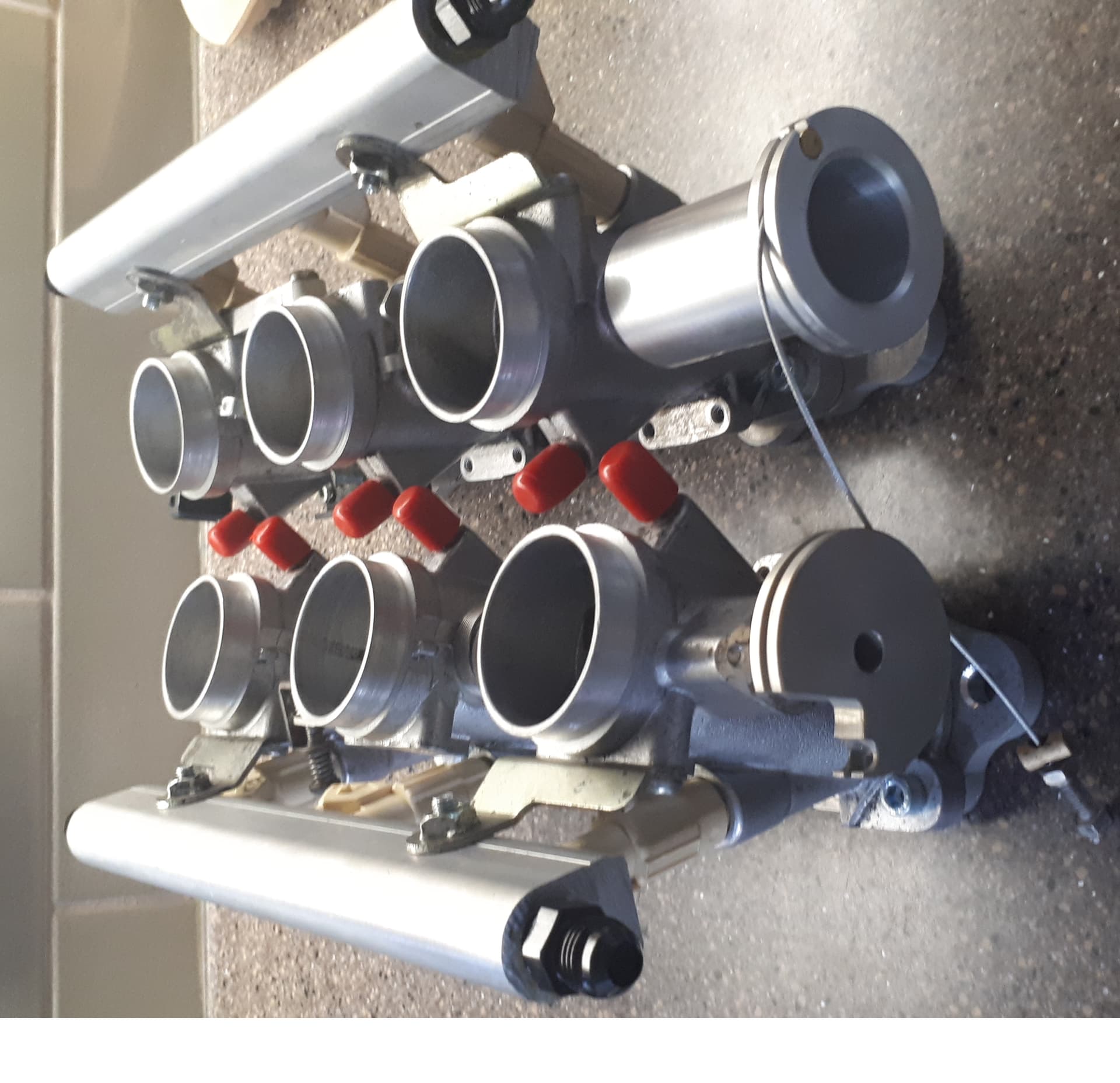

I am working on a Mazda KL=ZE conversion. the 2.5 from an MX6. This is the next part to be installed.
Very cool. Do you have a build thread on the go?
