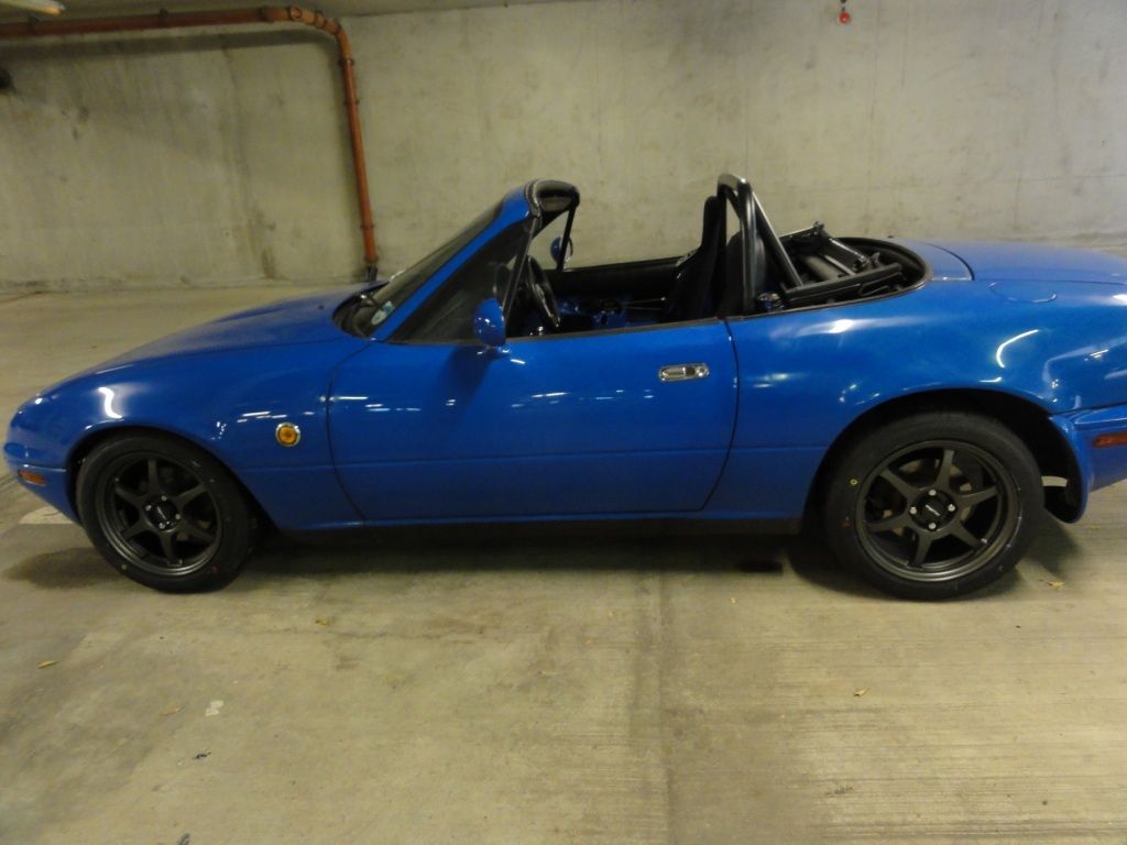

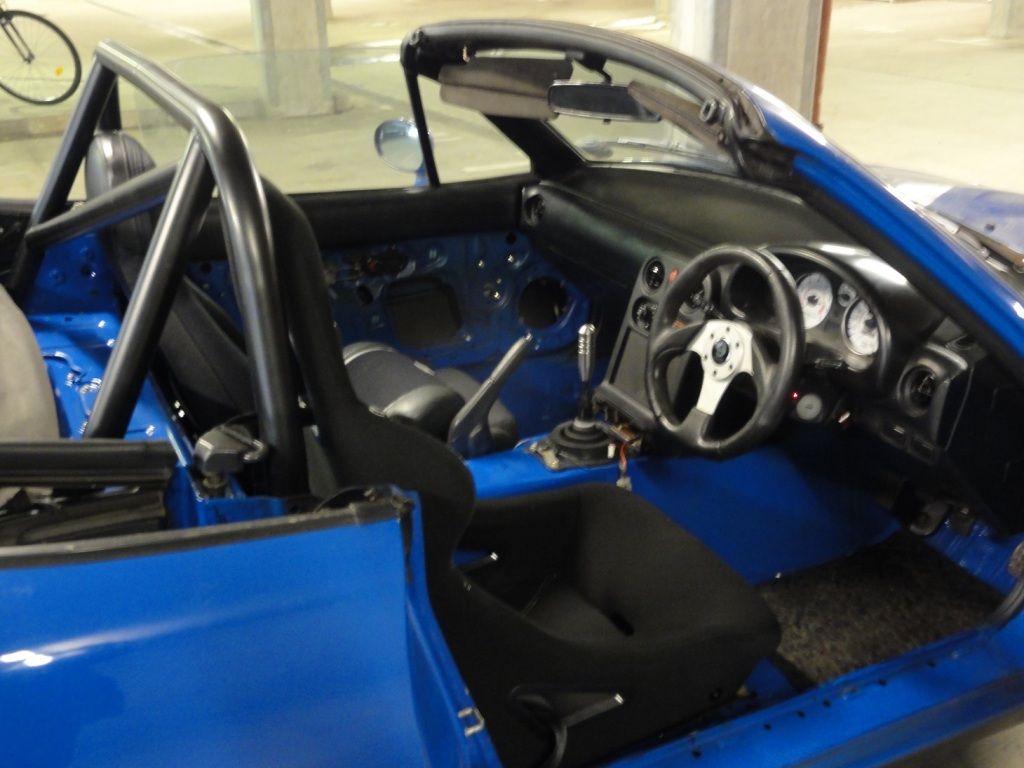

Heres mine, roof folds fine.
Typhoon, thanks for the photos. Looks like it does fit in there fine. Does your car have a glass or plastic rear screen? Do you have any handy tips for installation?
Pete
It has a glass window. This bar is the bigger TD Roll bar, the front mountings located differently to the GP Roll Bar but fitting is essentially the same. As you can see from the picture you are likely to need something to push the legs apart or pull them together (ratchet straps) to get to them to fit perfect. For the rear legs I used a punch to indent the metal from the top and drilled the holes from the bottoms as there is no room to get a drill there from the top. Iuse a smaller drill bit and then a 12mm tapered reamer bit to enlarge the hole. I drilled everything in situ - no measuring - just put the bar in and drilled the holes while the bar was in place. Use some rustproofer/underseal on the reinforcment plates and bolts under the car. It is pretty straightforward really - took about 60min (I had the carpeting out before hand).
