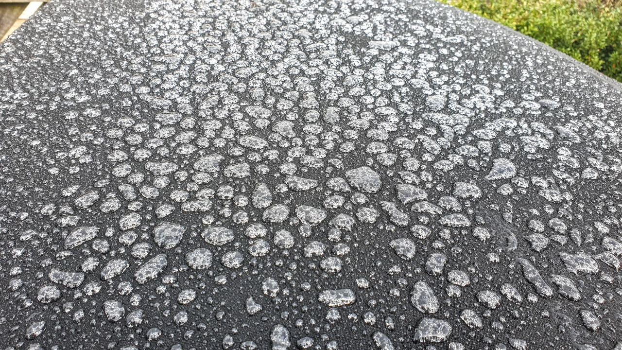

Your Hood should now look brand new again!!
Here it is finished after an hour of rain: 3 weeks since applied
