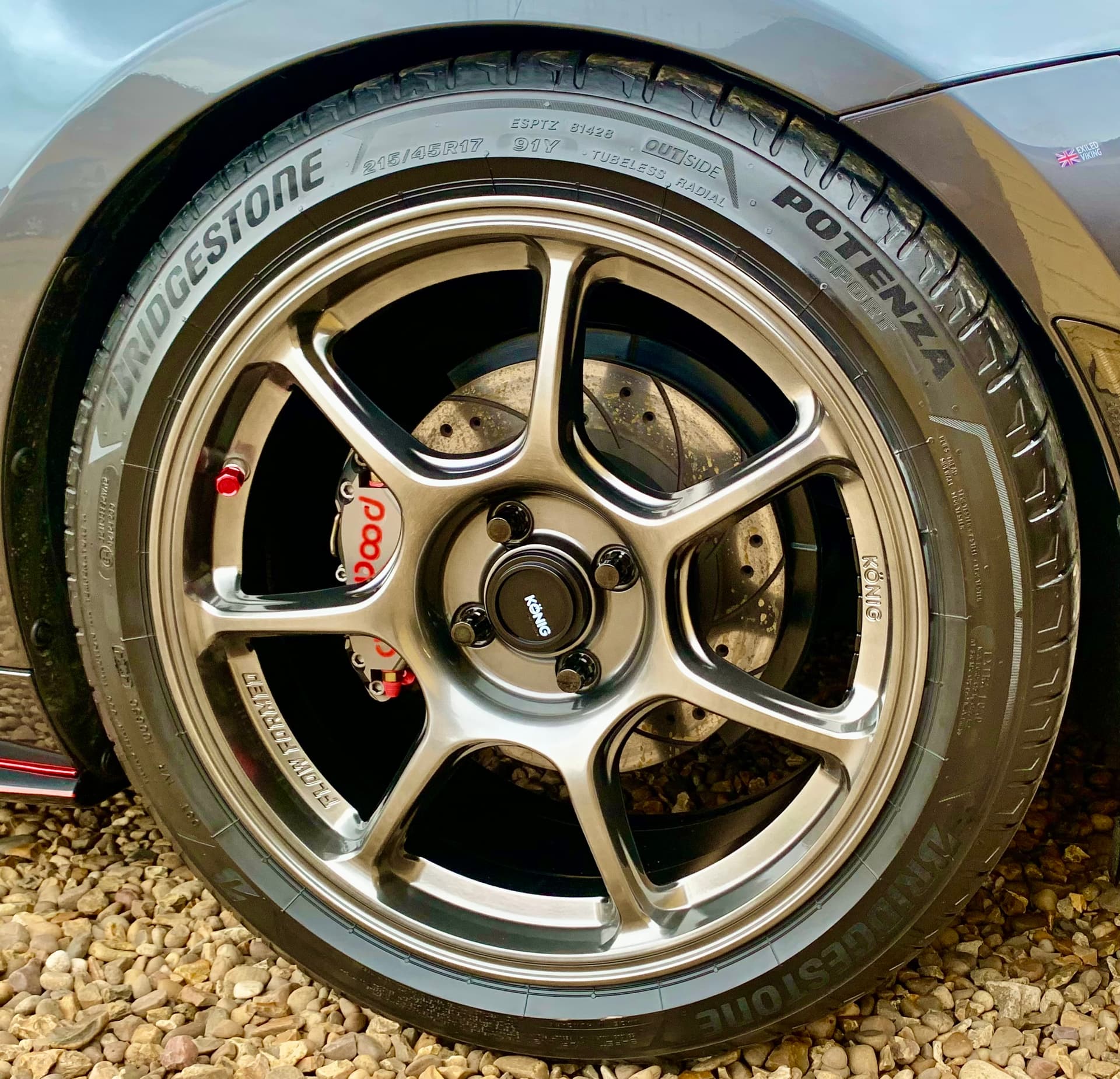

Konig wheels 17x8 215 -45 Brigdestone tyres fitted with MeisterR suspension fitted 20mm spacers all round set up by my self checked by the local garage every thing ok no rubbing …As yet :wink:
What offset are the Konigs please? That looks just about perfect and if you report no rubbing, is perfect :wink:
Yes…
Do you have similar photos to these showing the wheels from side of your ND?
