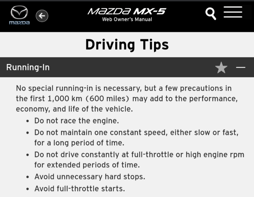

If I remember correctly, this section isn’t in the physical owner’s manual for European supplied ND1 and ND2s whereas it is for North American equivalents.

Lots of advice but surely just speak to the dealership and do as the owners handbook tells you. Thats the only advice I would follow

Handbook, yes

The handbook, like you said, says it all.
