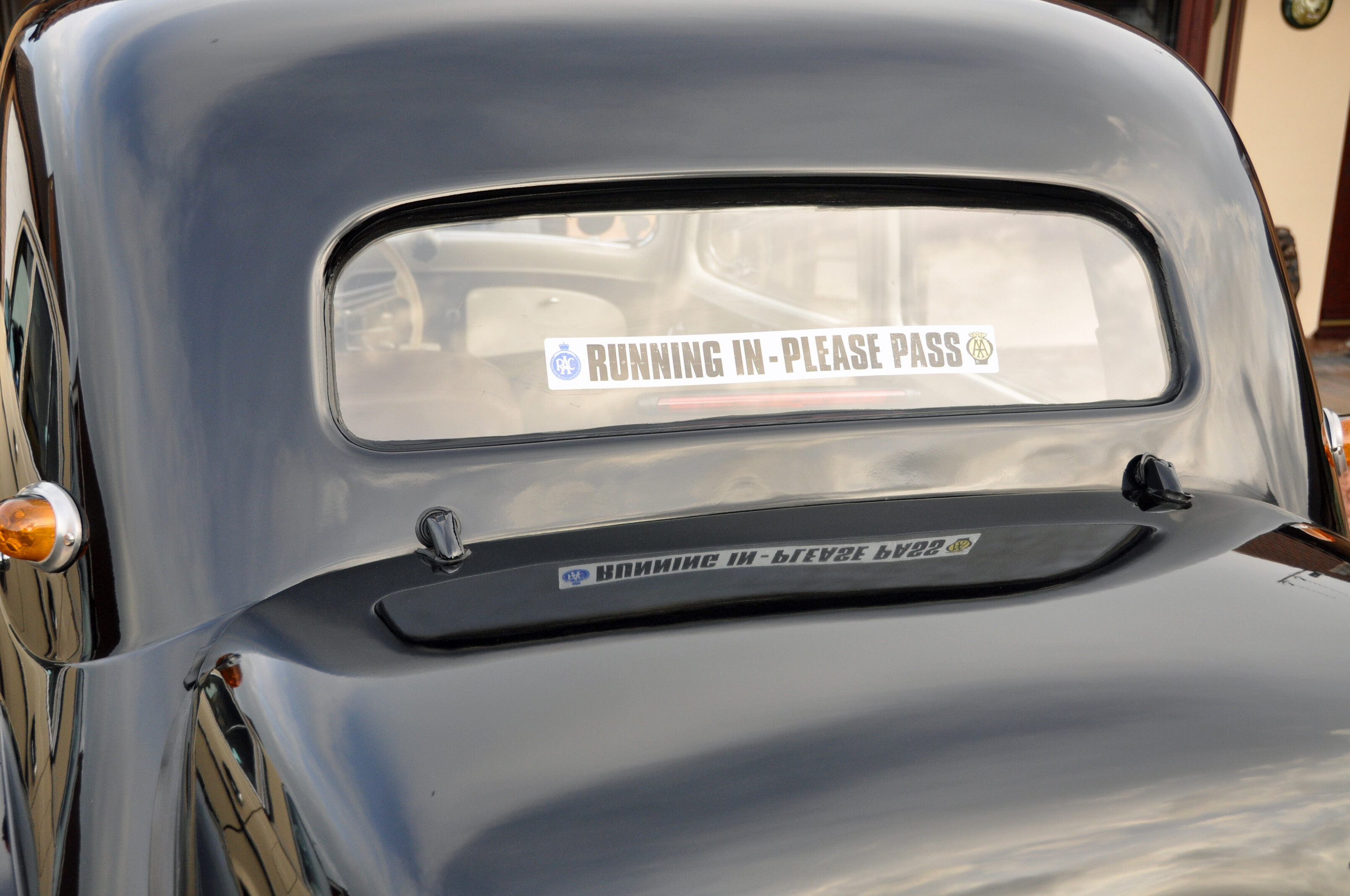

Remember these?
Oh yes ! But where I grew up, it was normally written on a piece of cardboard stuffed in the back window :joy:
