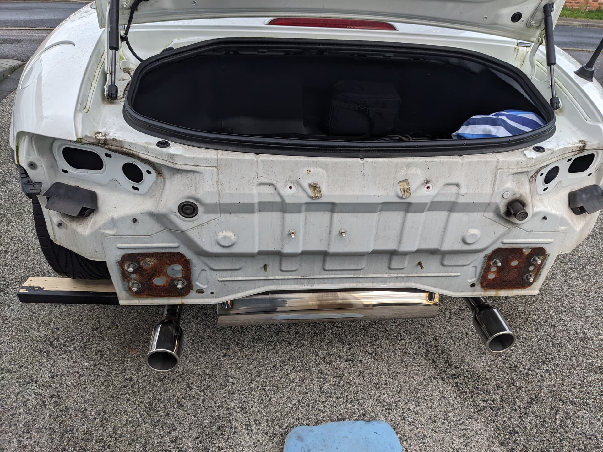

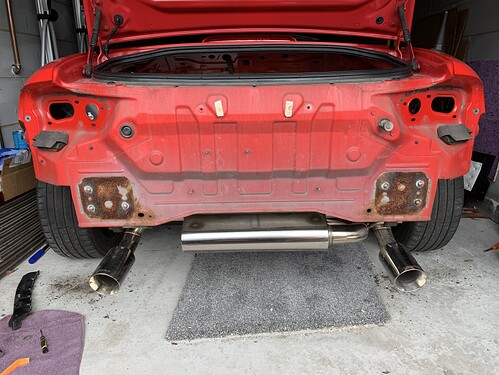

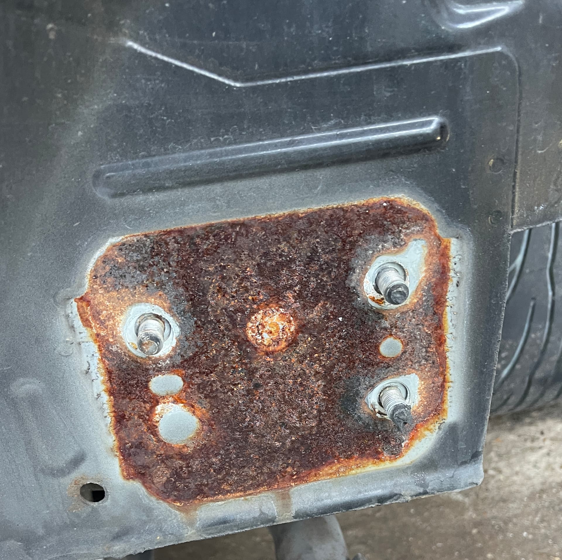

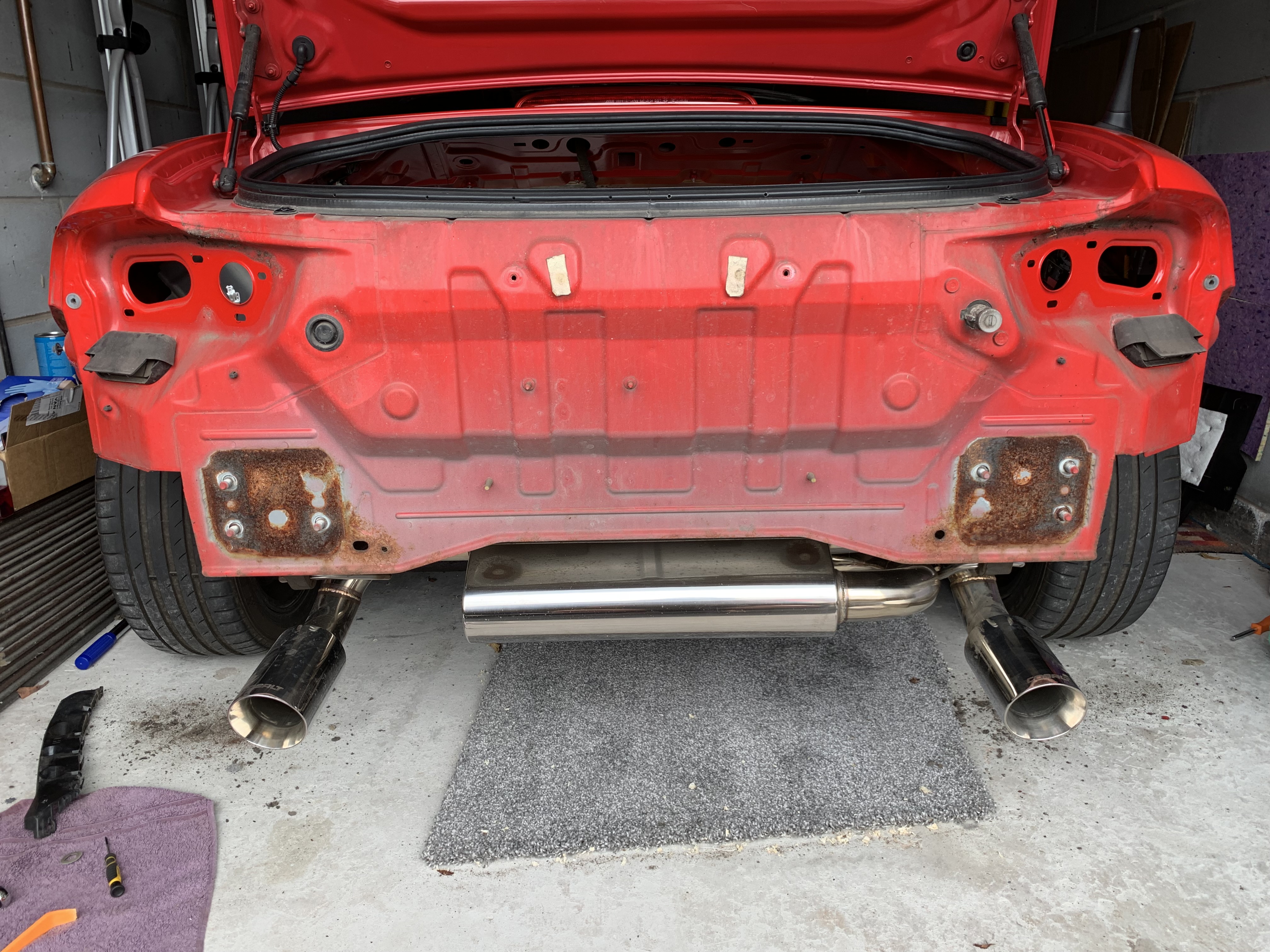

What are the long term consequences of leaving the rear crash bar untreated? I realise it will corrode more, but are we talking about potential MOT failures further down the track or major safety issues?
Probably all of those you mention as being problems if left untreated.
BTW the rear crash bar is a pretty hefty piece of metal and formed to take rear impacts of course. It’s not that that needs treating for rust so much it’s the panel it’s bolted to. Those square rusty patches can just turn into holes. I’ve seen a picture of a badly corroded NC’s rear panel where the crash bar fixings had almost parted company with the car.
