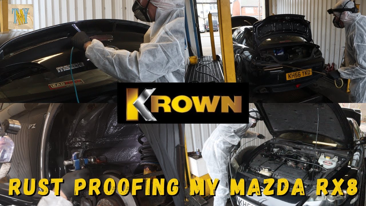

The quote was £275.
Said it would take about 3 hours. They sent a link to a video to show the process…
Hope this helps.

The £275 treatment above on the RX seems just a coating of wax, much like Lanoguard, remove any loose stuff/dust and spray away, rinse and repeat the following year if you use your motor throughout the year. It’ll probably last longer if it’s never taken out in the wet and kept cosy in a heater garage etc.
Incidentally I didn’t like the sprayer coating the the engine bay/outer bonnet area with the stuff and no covering on the cars paintwork either.![]()
