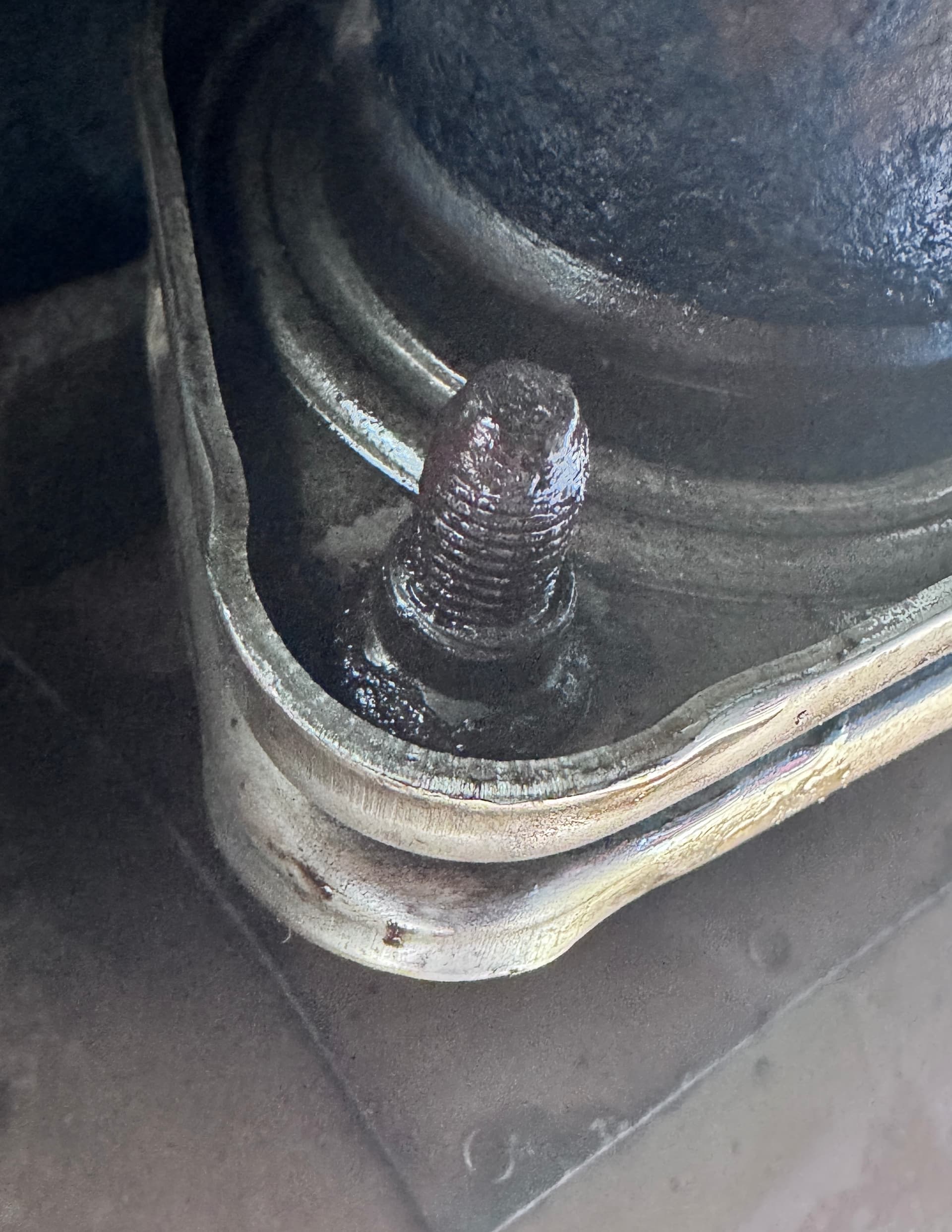

  2. I’m looking for technical help or recommendations on: rusted and rounded exhaust bolt
Hi everyone, I am trying to install a new back box on my NC. I took one bolt out no problem, but the other one is pretty rusted on and rounded.
I’ve ordered some extractor socket, do you think it will work or should I just go straight to cutting the bolt out?
Cut it off, your replacement back box (aftermarket) will have to be fixed with nuts/bolts anyway to fix it on.
In my experience get a proper crush gasket if one isn’t supplied with the new box, the thin ones with the holes in aren’t very good at sealing the joint.
Thanks Mick. First time working on any car and am already being thrown in the deep end :melting_face:
What tools do I need to cut? Like a dermal? And where is the best place, in between the gasket?
Here’s the type I’ve used. Tap them on with a hammer first then gradually add more torque till it starts to turn. They’ve got me out of a jam numerous times!Nut remover on Amazon
I feel and have felt your pain.
so the nut is welded on? What kind of evil person would design something like this?!
Time to throw in the towel and give the local shop a call. Thought it would be an easy weekend job
Yeah cut it between the flanges if room, a thin blade. You’ll probably end up ditching the OEM back box, not many want them SH and they aren’t worth much anyway
