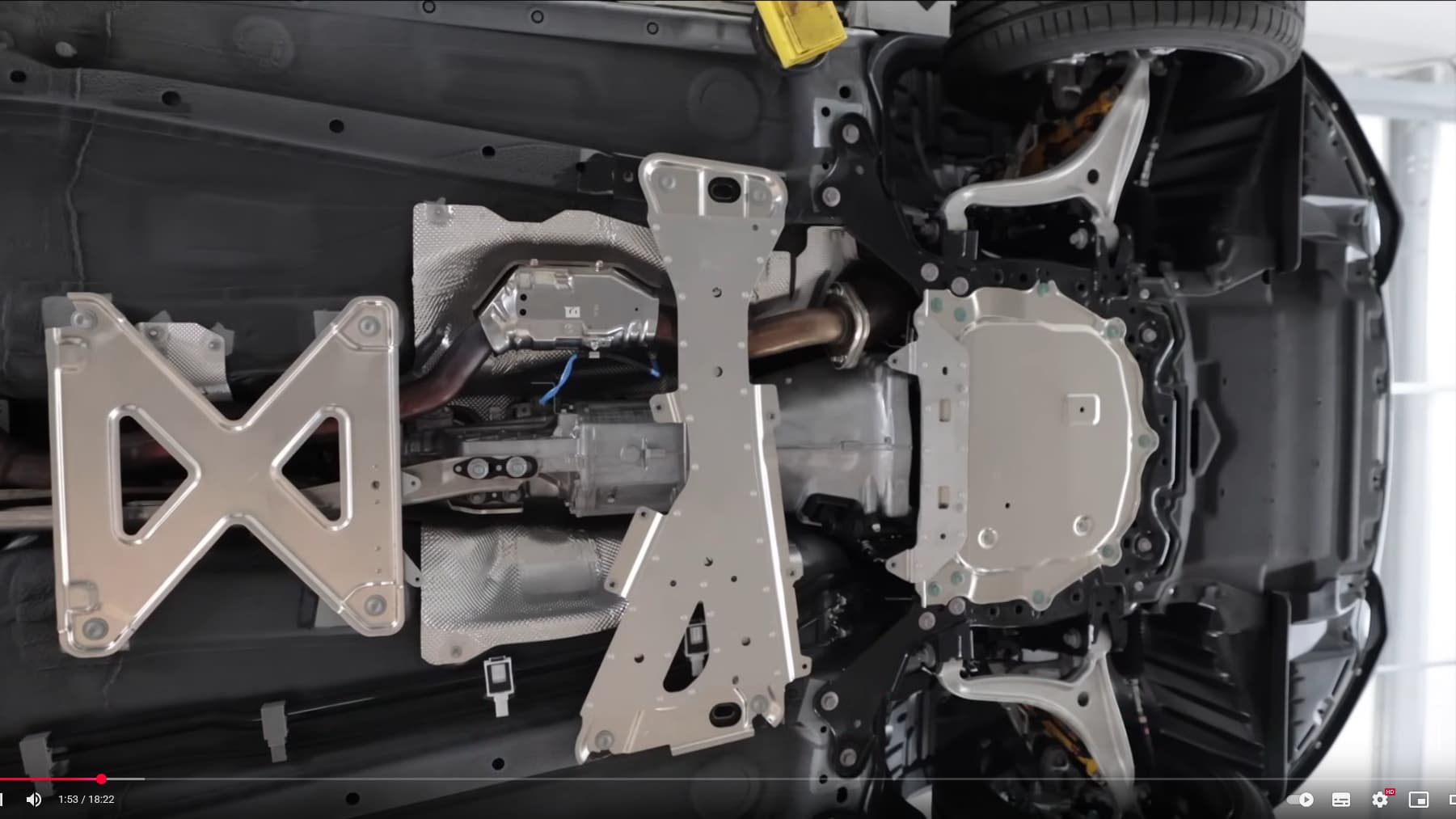

Also through the holes used by front wheel-arch trim clips to access the front chassis rails, pics here show which way to aim.
