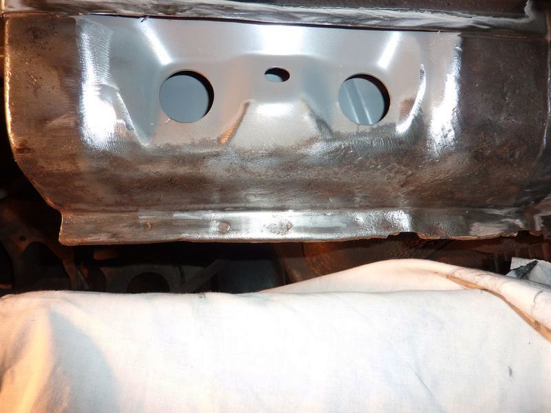

I wont bother with how you inject cavity wax as its been done to death however the rear outer sill is always quoted as inaccessible however its not.
See photo below taken from the web (hope is ok) The two ends are sandwiched together and are the difficult areas but I reckon that if you can exclude air and water after treating it will prolong the cars life.
Access is via the large hole below the seat belt tower and spray Kurust over and along the angled section into the thin gap between the angled section and the outer three quarter wing area and leave to dry for a few days. Then heat up Dinitrol 3125 in the airing cupboard for a day or so making sure its like water and spray over and along the angled section again and flood the area. An endoscope proved it had flooded that section.

rear sill
The problem with the rear sill section on the MK1 is that the intermediate skin is too close to the outer skin. This promotes corrosion and makes it very difficult to get treatment or corrosion protection where it  is needed. Basically the two sections fuse together with rust and only separate when one or the other or both corrode away completely.
I would reposition or reshape the repaired intermediate section to be further from the outer skin to allow better ventilation and accessibility for rust treatment.
In Japan there is the option of a plastic outer sill repair. Doubt it would be allowed here but at least the inner sections could be properly finished and treated with that being burned off when the metal outer sill is welded to the car.
Agree completely however the centre section is not butting against the sill - the bits that do are at each end from research I carried out with the rear end wrapped around and the front spot welded therefore if you can get the ends and bottom sealed and exclude moisture and air it will delay the inevitable in my view. You can see the thin gap I sprayed down between the centre angled section and the outer wing via the hole under the seat belt tower
Better picture below
