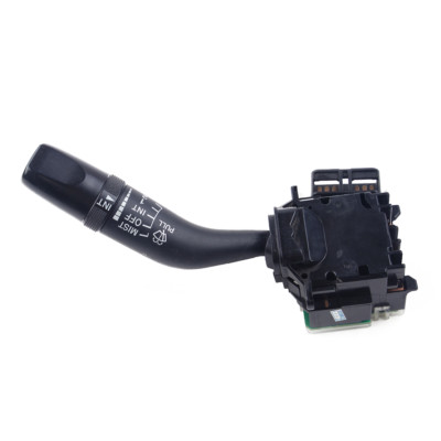

I have fitted the rx8 wiper stalk to my NC.
I’m guessing from the INT is that the adjustments only work on the INT setting and not 1 and 2?
There’s me thinking it would give like 30 levels of adjustment.

That’s my understanding; instead of just getting a preset time between wipes on INT, you can choose the interval. I bought a RX8 wiper stalk a couple of weeks ago, but haven’t got round to fitting it yet. Easy enough?
Very easy to fit, just a few minutes.

Got mine off of Fleabay. 5 minutes to fit and gives you adjustable intermittent wipe from about 2 seconds to 10 seconds i’d guess.
I never understood why this was never standard. The single speed INT just doesn’t do it. Brought an RX8 one used, 5 min job to fit.

Done on my NC. Literally a 6-minute job. And SO much better in drizzle/spray.

Does this work ok? Are you pleased with it? Just had a peep on eBay and the RX8 ones seem to come as a complete unit with indicator stalks

Yes, that is how it is, a plug-in box with one stalk.
The switch arrangement on the stalk is different as well as the circuit in the box, so it needs to be a complete assembly.
