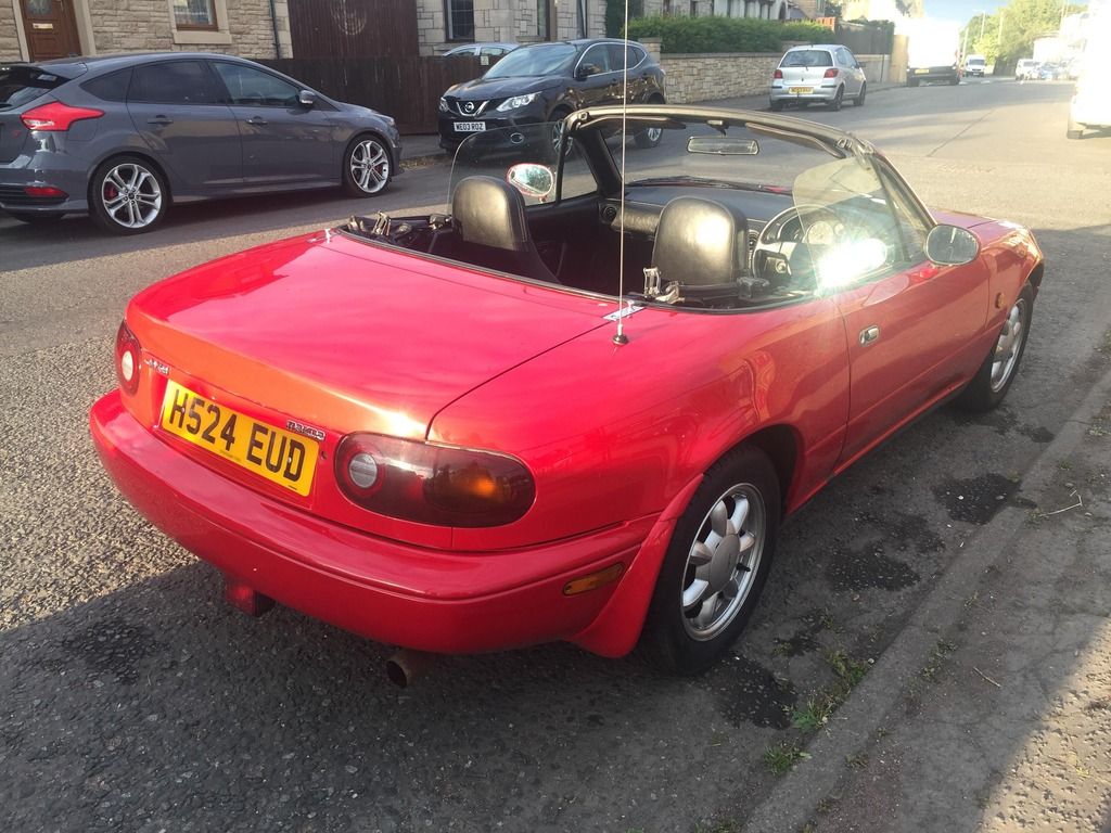

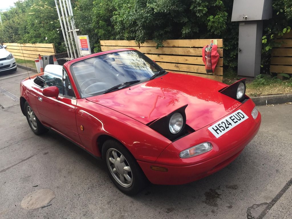

About 2 weeks ago my wife seen an mx5 locally and it was cheap so she bought it. it has since sat doing nothing so i have pinched it for myself
this is the day she picked it up.
dont let the pictures fool you as there is a good few problems.

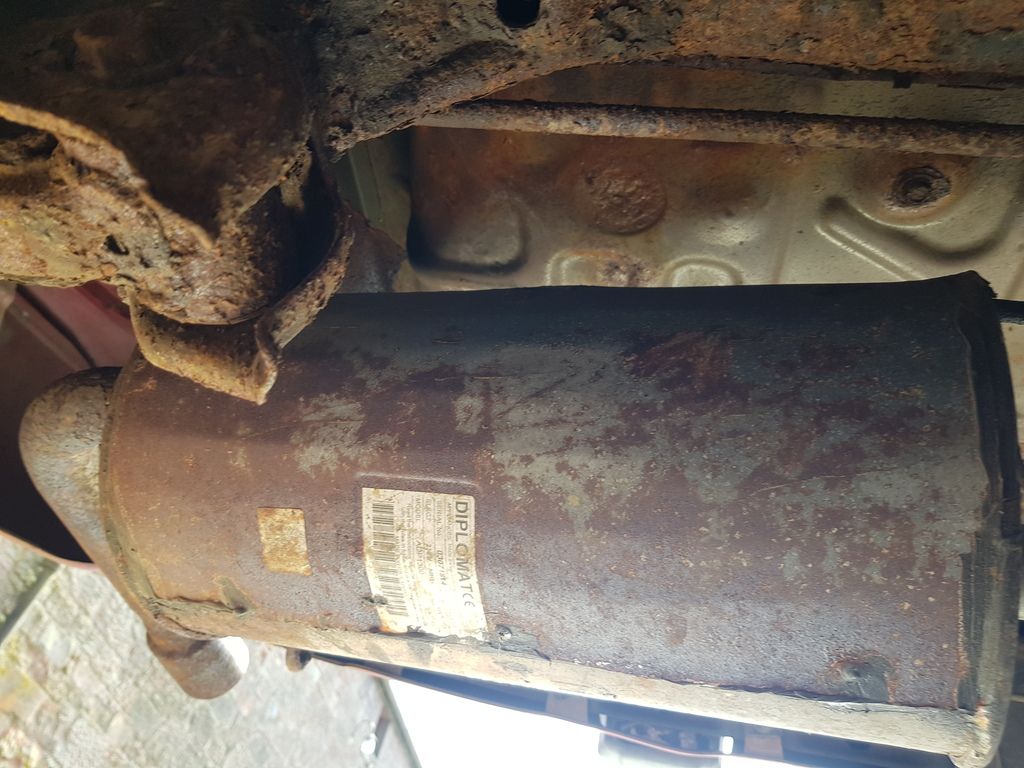

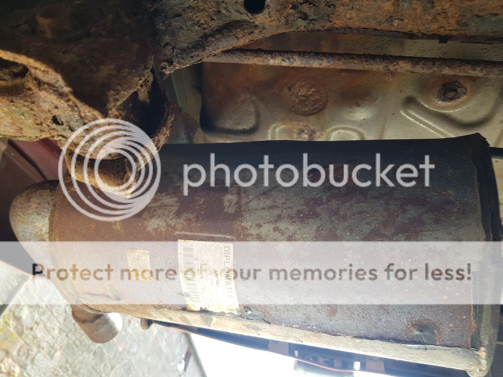

Well… someone has pop riveted a bit of tin over the crusty exhaust!
new one ordered along with a decat! hopfully be here tomorrow

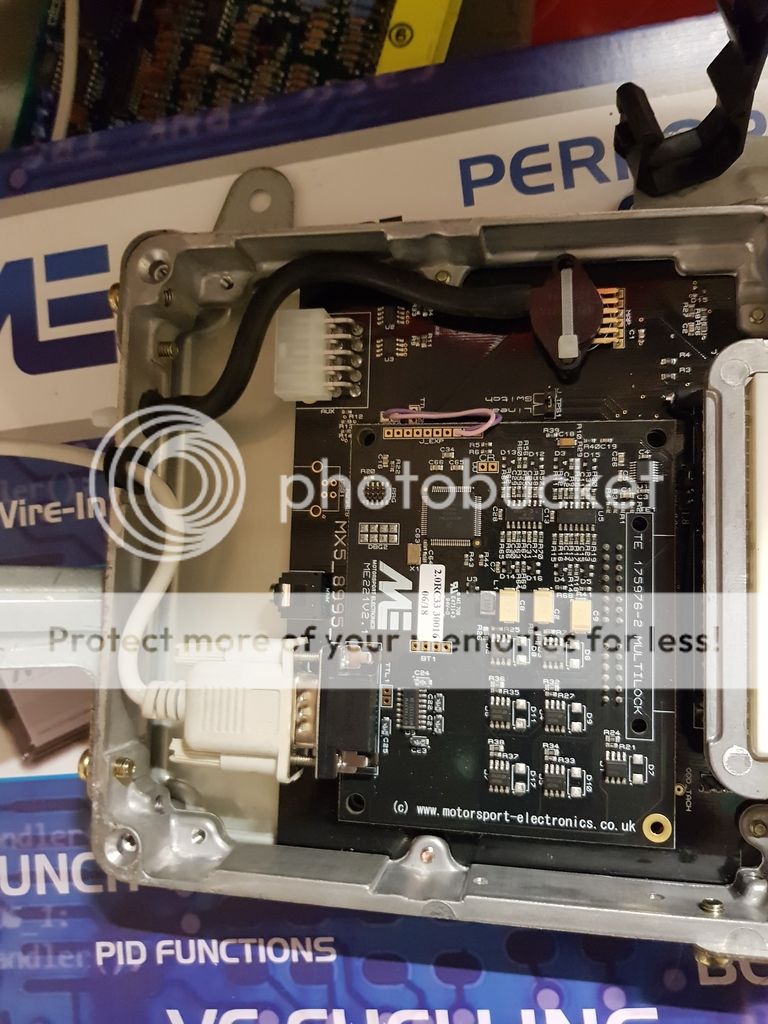

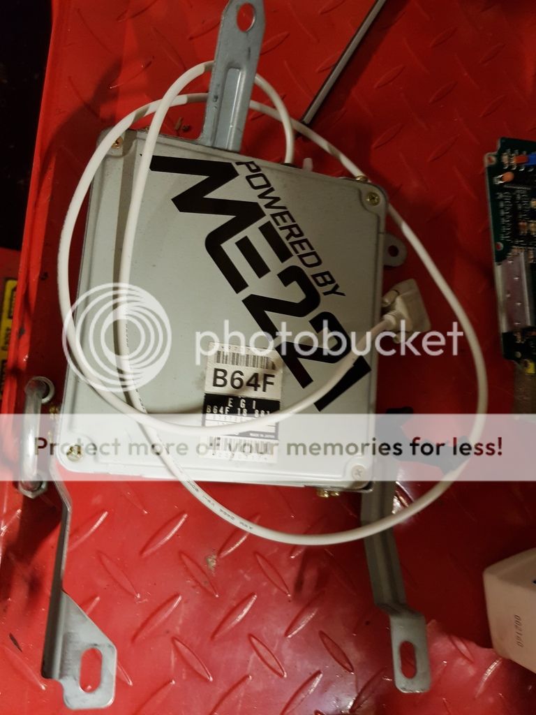

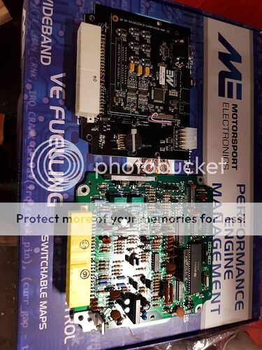

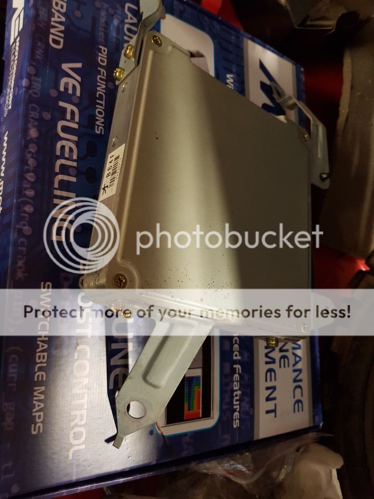

I haven’t had much time and couldn’t be bothered climbing under the car so decided to start on the me221.

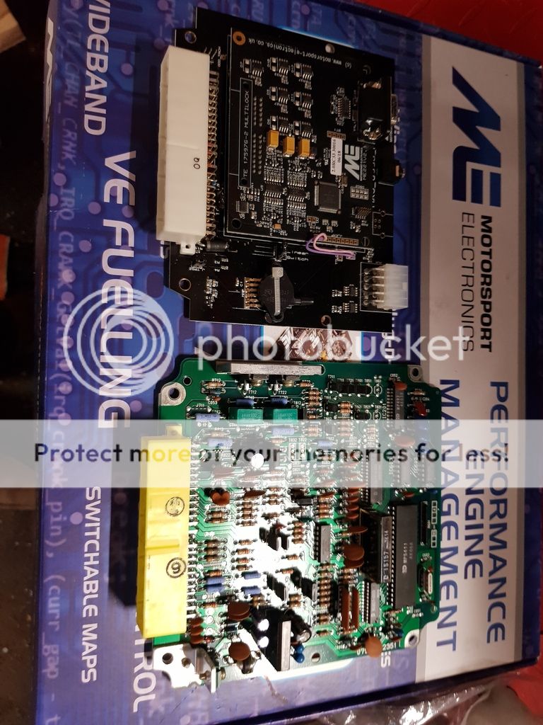

Ecu Removed.
New Vs Old

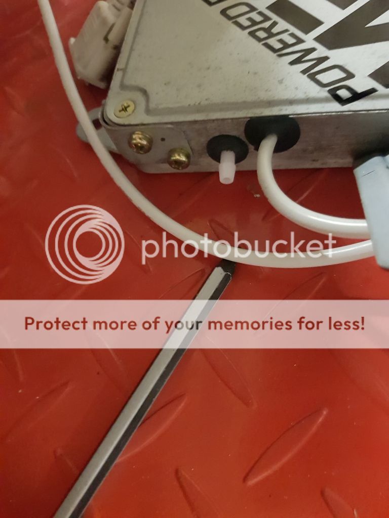

I drilled 2 holes for the data cable and the MAP hose. I wanted to be able to remove the ecu without needing to take the cover off first.
and the finished ECU with sticker added for extra BHP

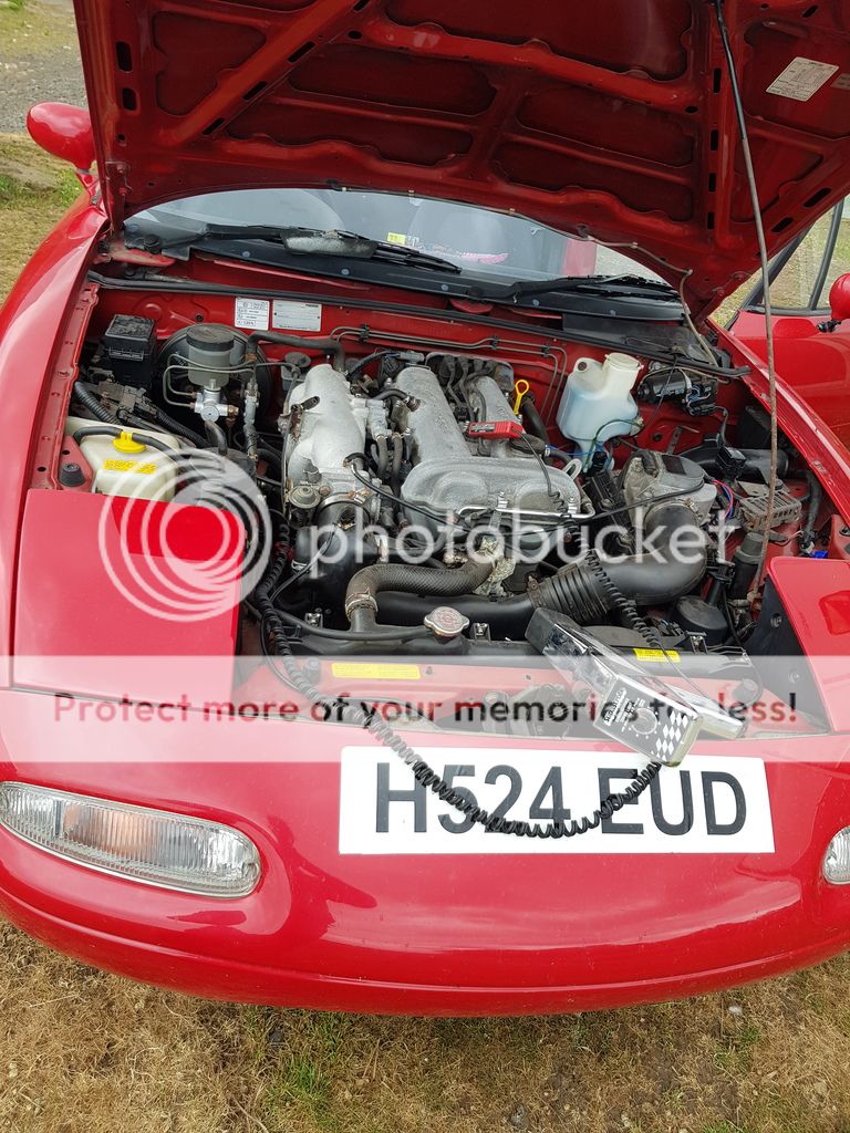

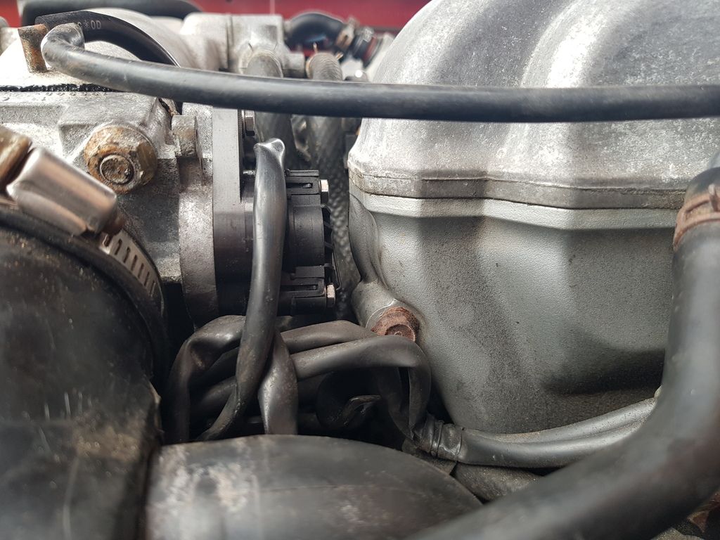

back in the car but had issues with the timing and the poor TPS the 1.6s come with. I have also fitted a IAT into the plastic piping at the moment just so I can start removing the MAF

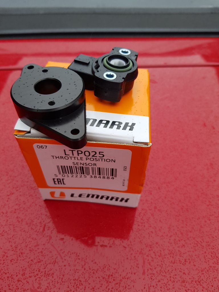

I ended up going to my local car parts place as I wanted a bmw TPS to fit the adaptor I got from ME
I however did find a wideband here since the one I ordered hasn’t arrived yet and I really wanted to know what my air to fuel ratios were!
also I set about fitting the BMW TPS

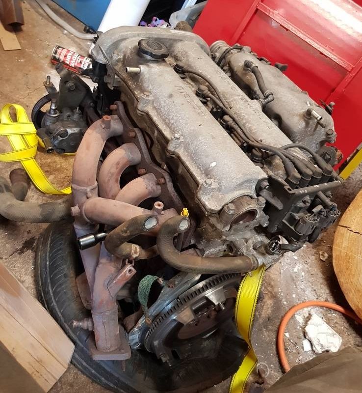

I found a 1.8 nb engine local for sale cheap so thought I will do an engine swap before I turbo the car.
That car is starting to look very well now ! Looking forward to seeing how the turbo work progresses
