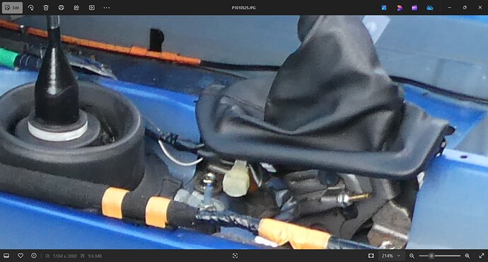

Why not just wire the handbrake cable as it should be.
By the time you have the centre console out so you can fully remove the stereo - it will only need a wire bringing to the handbrake area to connect up that function.
You can see the wires at the front edge of the handbrake boot in this picture

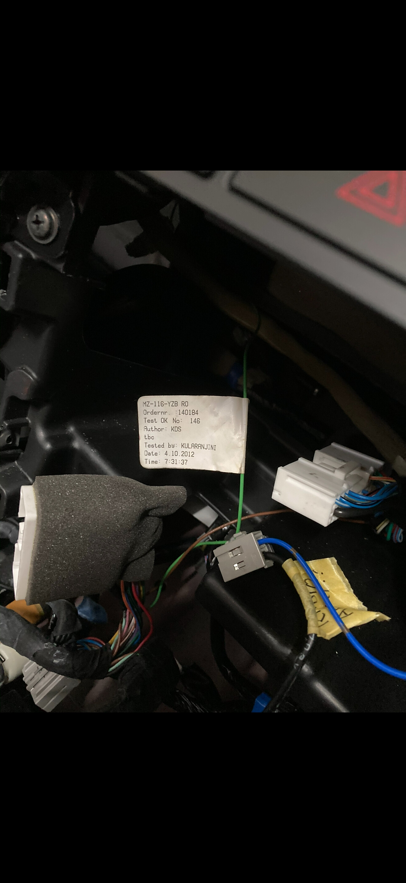

The large grey foam covered socket is the main harness one.
As Scarletpimpernel says, when you’ve unplugged your TomTom unit track the harness back (it may be covered in a foam sheaf) to that plug shown above. This is were you plug your purchased harness in. Not sure on that Mazda premacy harness, give it a go or cross reference it for fitting your model too.

Yep I traced it back to the harness covered in foam unwrapped the foam and everything but physically couldn’t unplug the Sanyo harness. Maybe I wasn’t strong enough or didn’t push down the tab enough but the two just weren’t separating :sob:

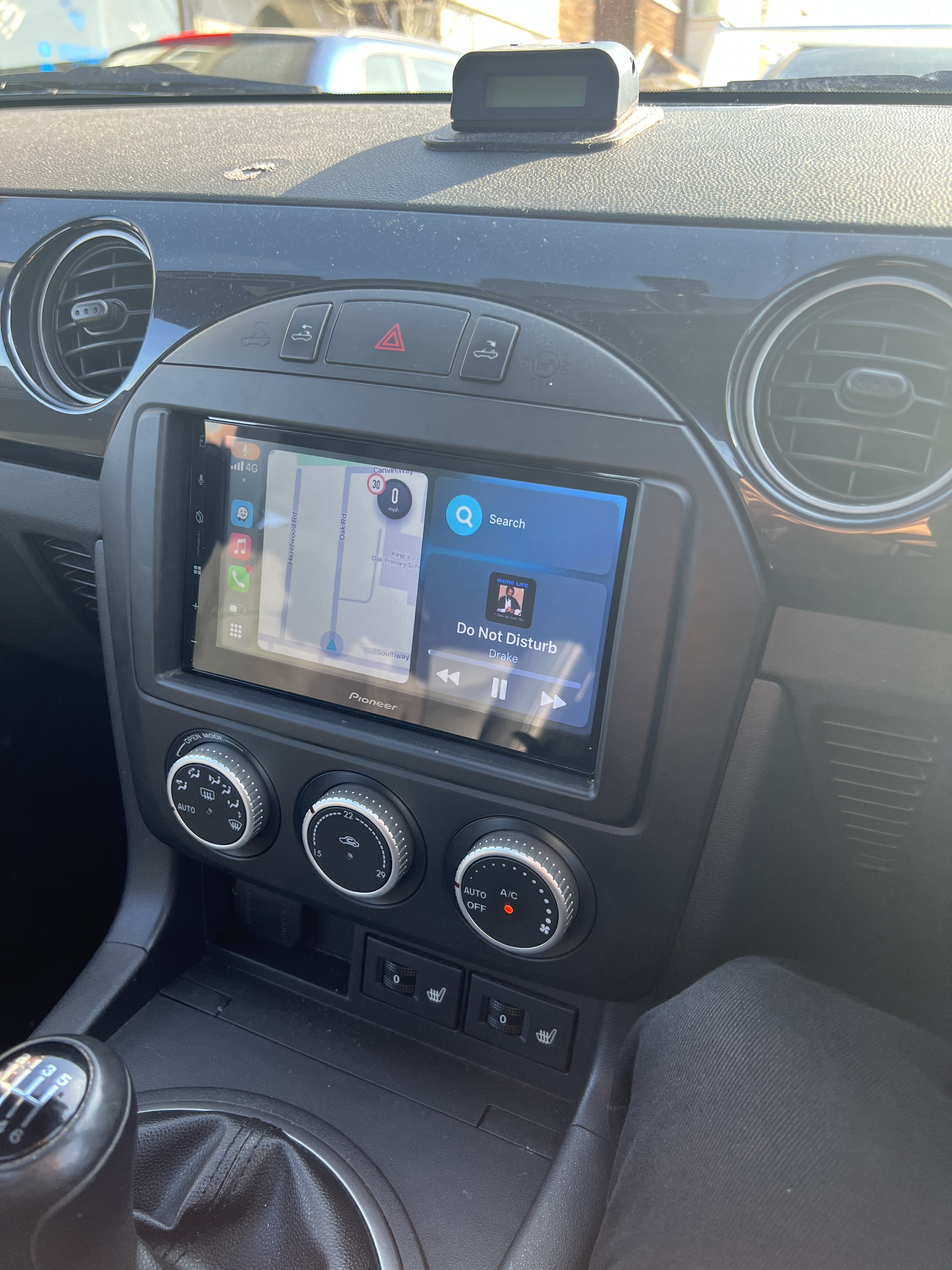

Just thought I’d drop an update, I’ve got my headunit fitted! Fitted by a local shop but looks like it was a good job.
I can confirm you can use the InCarTec TomTom SWC harness for our units and it all works fine. Volume up/down, track up/down, mute, and mode buttons all work. Shame that there isn’t a pause button on the wheel as well. Also for my Pioneer unit, the existing fascia fitted so didn’t need to use the one I bought.
Overall a great quality of life and audio upgrade!
