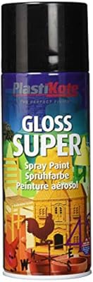

What about Plasticoat?
Never used it myself…just a suggestion.
Comes in matt as well…
It may be too weak to withstand general use I guess?
Thanks for the suggestion Scottishfiver, I’ve read some of the questions on this product and not enough evidence to suggest it would work for me. So on that basis… I’m out… thanks again though! :wink:
A quick update…today I applied this product (see pic) to the whole panel containing the scratches and it seems to have done the trick. The scratches (which were more like scuffs) have been adequately disguised. I’m sure there are several similar products that would do an equally good job. Thanks again for suggestions.
