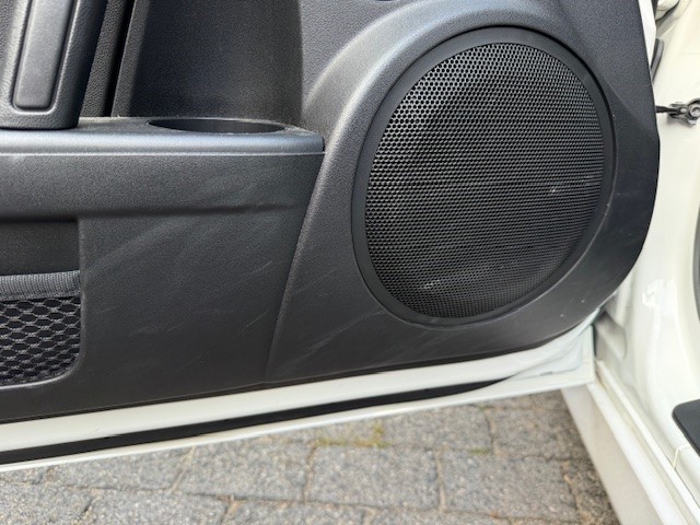

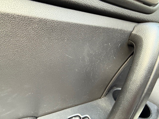

Hi all,
Whilst cleaning the interior yesterday I was annoyed by the scuff marks on the door panels.
A while ago I had read a solution to remove these, but I am not sure if it was on this forum or somewhere else. I have tried the search function but could not find it.
Any advise on how and if it is possible to remove these scuff/ scratch marks ?

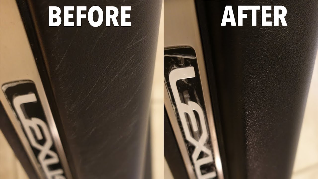

I’ve not tried it myself so don’t know about the results but one way seems to be heat. Watching the videos it seems to make the panel look a bit shiny but I wonder if this is because its still warm.
Anyone tried it?

I think the scuff marks are to deep in the plastic to clean them out.
On another FB MX5 forum they gave a tip using a hairdryer. I am not so sure in using this, maybe on a low setting and making sure it does not heat the plastic up too much.

With deeper marks like that, the only permanent solution I’ve found is to use a heat gun, to gently work the area without resorting to too much heat.
The hairdryer may work, but may not be as regulated with its heat output. All other options are just attempting to mask the problem really.
