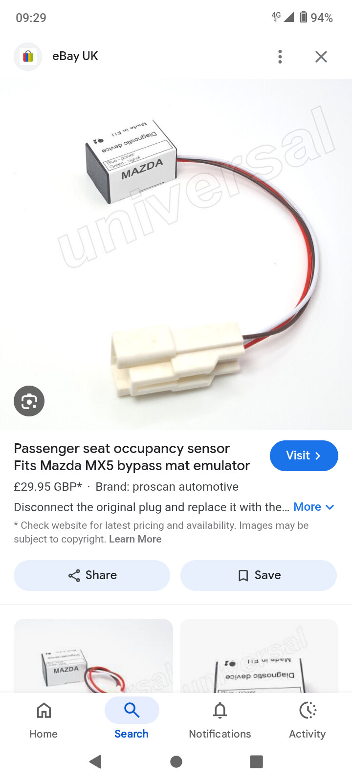

I have a 2007 NC - does the passenger seat occupation sensor need to be working for the passenger airbag to work in an accident?
Yes, how else does it know to fire it?
If the sensor is broken and thinks there is a passenger but there is no one there then the airbag would go off unnecessarily.
So do people with aftermarket seats just go without air bags?
I’ve been told that some cars just set off all airbags in an accident unless you switch them off manually - hence not knowing if the sensor was for the airbag, or just to annoy me about the seatbelt when I put a bag of shopping there…
Make sure you get sensor covering your year of manufacture, I’ve just downloaded this pic as a general pointer
