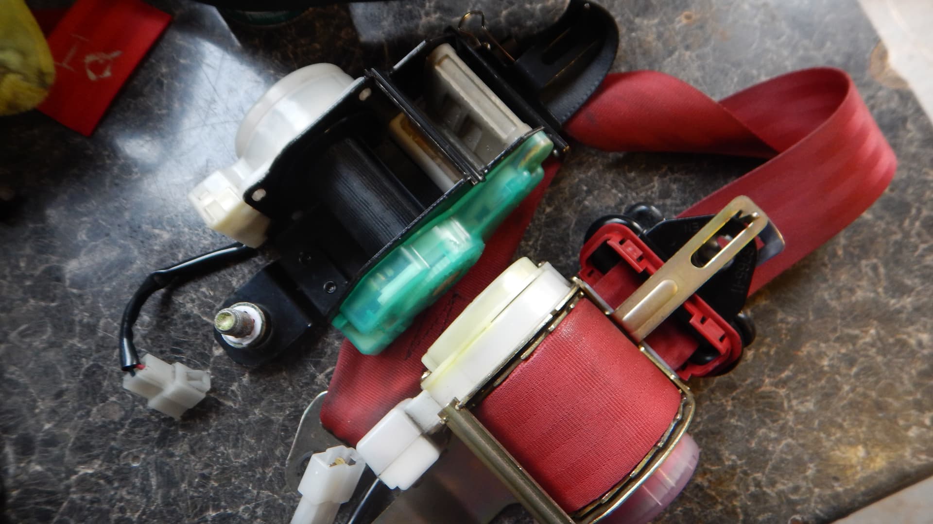

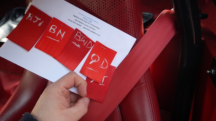

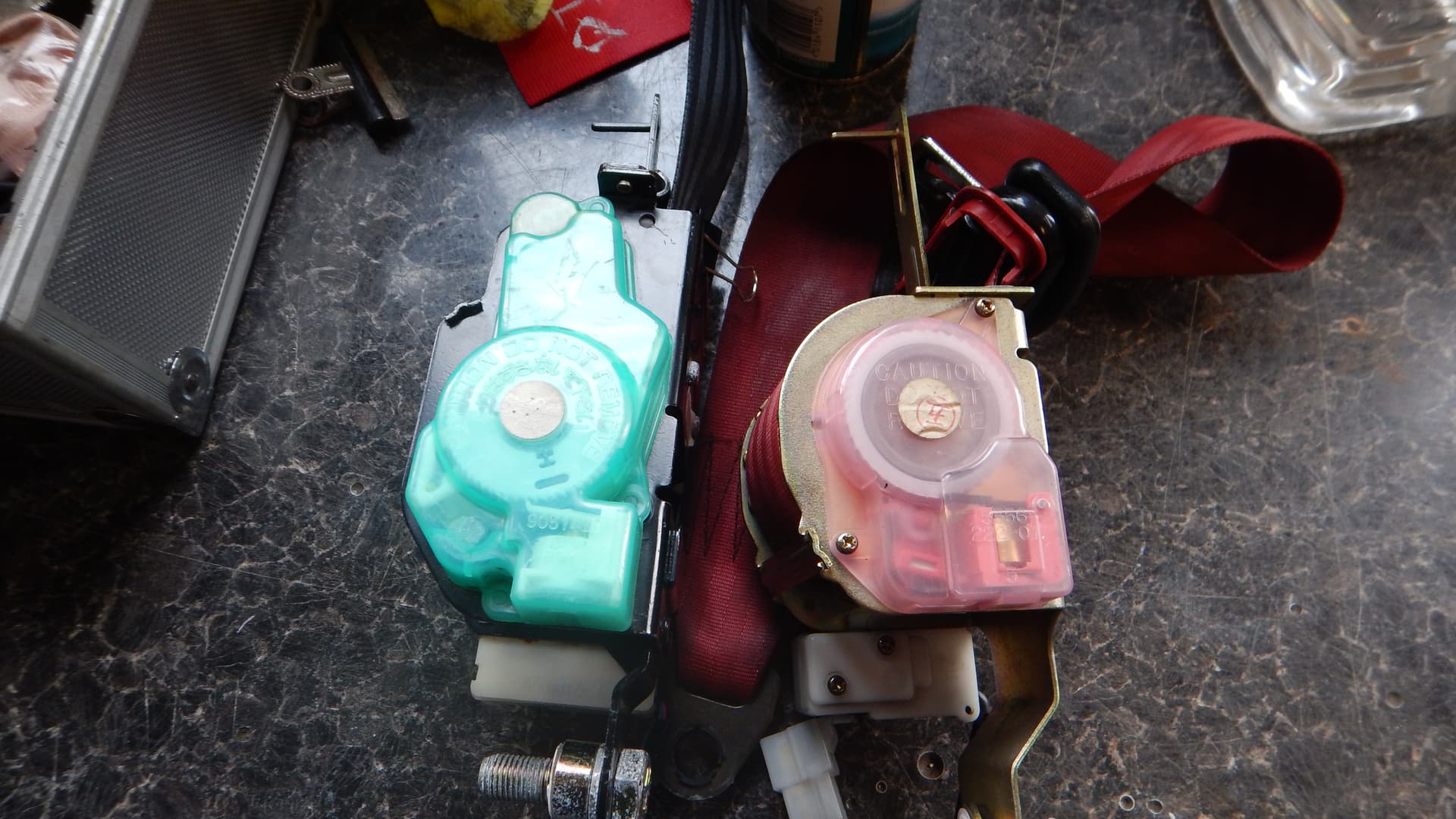

All JDM NA had it, but there are at least 3 different reel mechanisms depending on year and options. The reel will have a multiblock connector. Seatbelts from a breakers may not be safe, due to damage to the webbing. I had JDM belts rewebbed for about £60 by FDPS. A brand new Japan market belt from a UK Mazda dealer was about the same price as the equivalent UK parts.
1996 Non-airbag JDM versus 1993 JDM. Note connector blocks

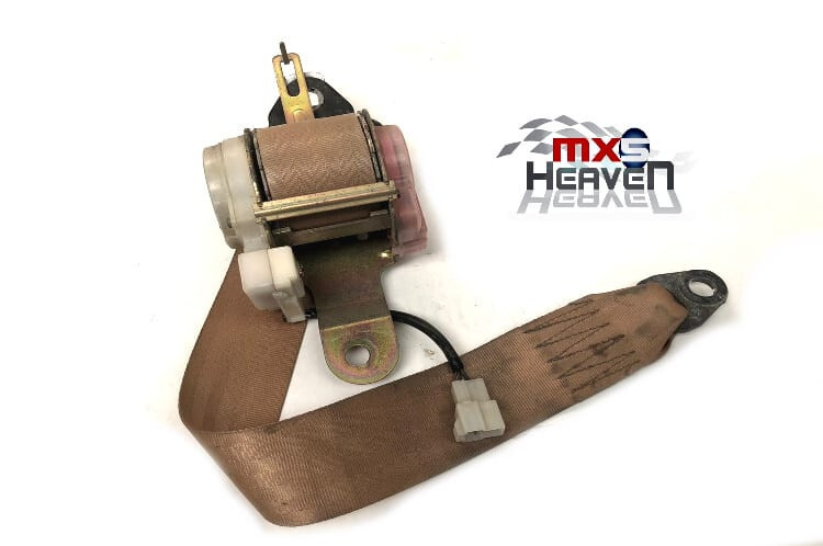

Rather disgusing looking used JDM early belt
And new EUR spec tan belt, illustrating the obvious differences in the reel
I believe 1992-1993 Airbag JDM cars had a different reel, similar to USDM, and later cars, post 1994, with airbags, had a further different design.
