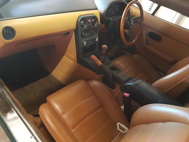

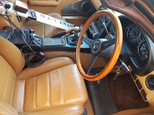

Advice needed on best way to repair these leather seats
There is no holes or anything just scuffed really any advise on what products to use and where to get them, I tried furniture clinic but they wanted to sell me 100 quids worth of stuff which in my eyes was far too expensive.

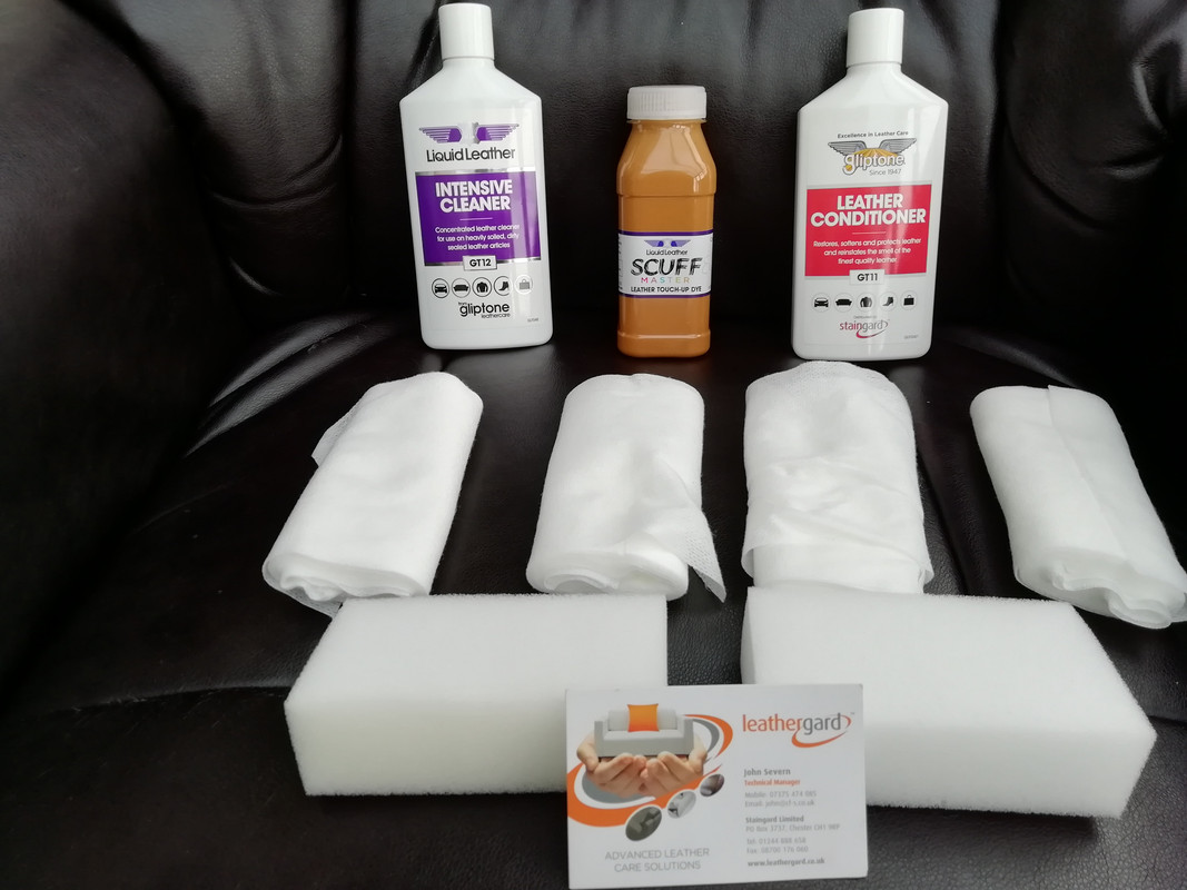

This the kit I used £34, I think you only need the cleaner and the dye, post more pics later, cheers Rob.
These are before
So there you go all DIY, seats left, in 4 coats of dye, used hairdryer, found it in the boot, the white paste to fill the cracks was decorators caulk the type you can paint over, put on with a credit card the hardest bit was to find the correct color dye, I went to the factory for the dye here in Chester four different Mazda Tan dye,s, my car is 1991 Eunos V Spec BRG and they had the very same sample and my car type on their card, Hope it helps you, Rob.
