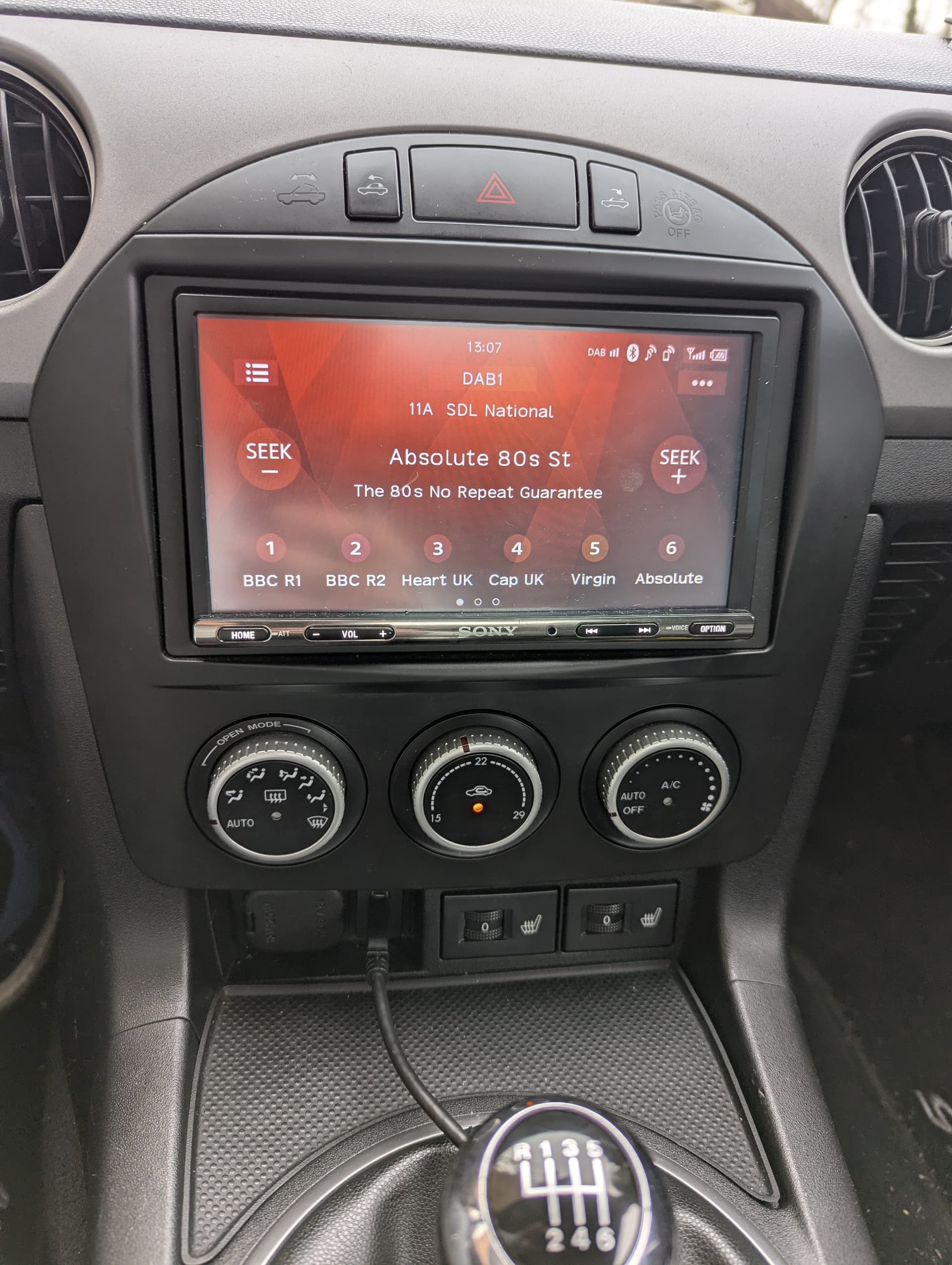

Success. Installed the Connects2 CT27AA136 and immediately it picked up DAB stations with 3 bars of strength. Better than the ebay splitter (so far anyway). Decided to take a couple photos:
Installed the new splitter. Blue wire connected to a red wire where the old ebay splitter was installed (this is just spurred off from a red wire which powers my Connects2 CTSMZ012)
Another photo after it’s all wired up

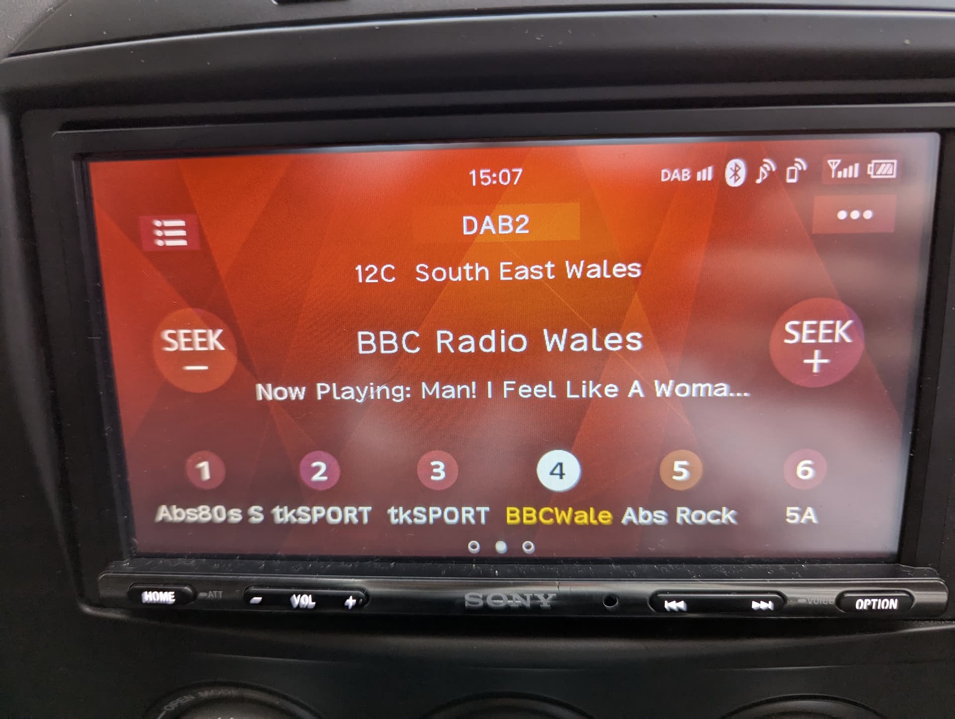

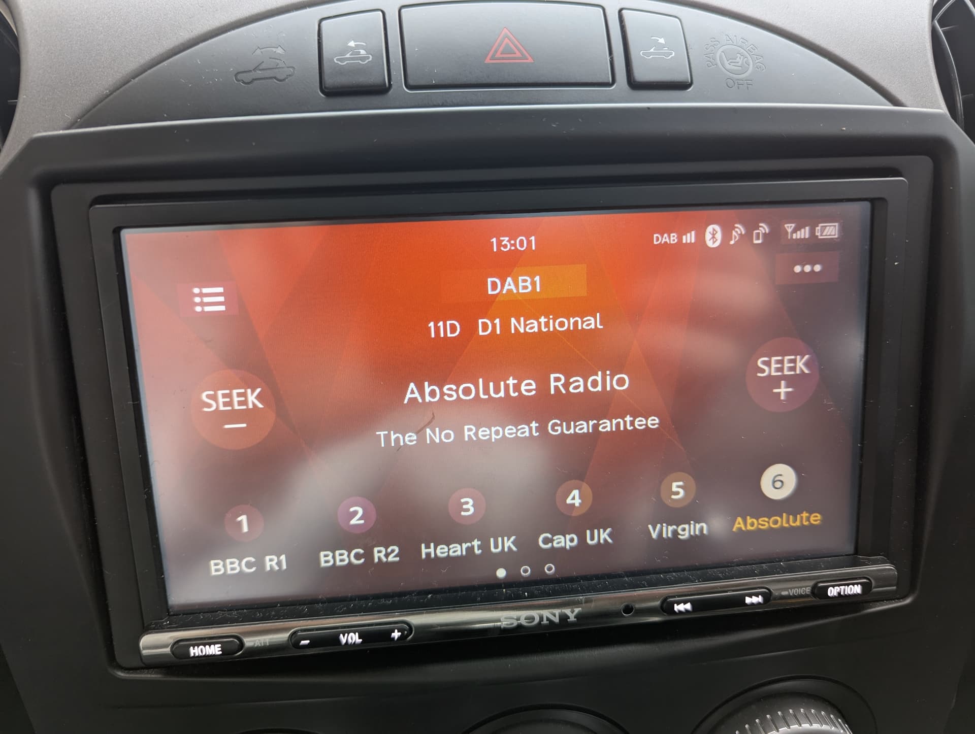

More photos post install. 3 bars on DAB on multiple stations. Did a retune and got ~85 stations. Also included a pic of the settings I’m using. Antenna power is on. I didn’t try turning it off as it’s working ![]()

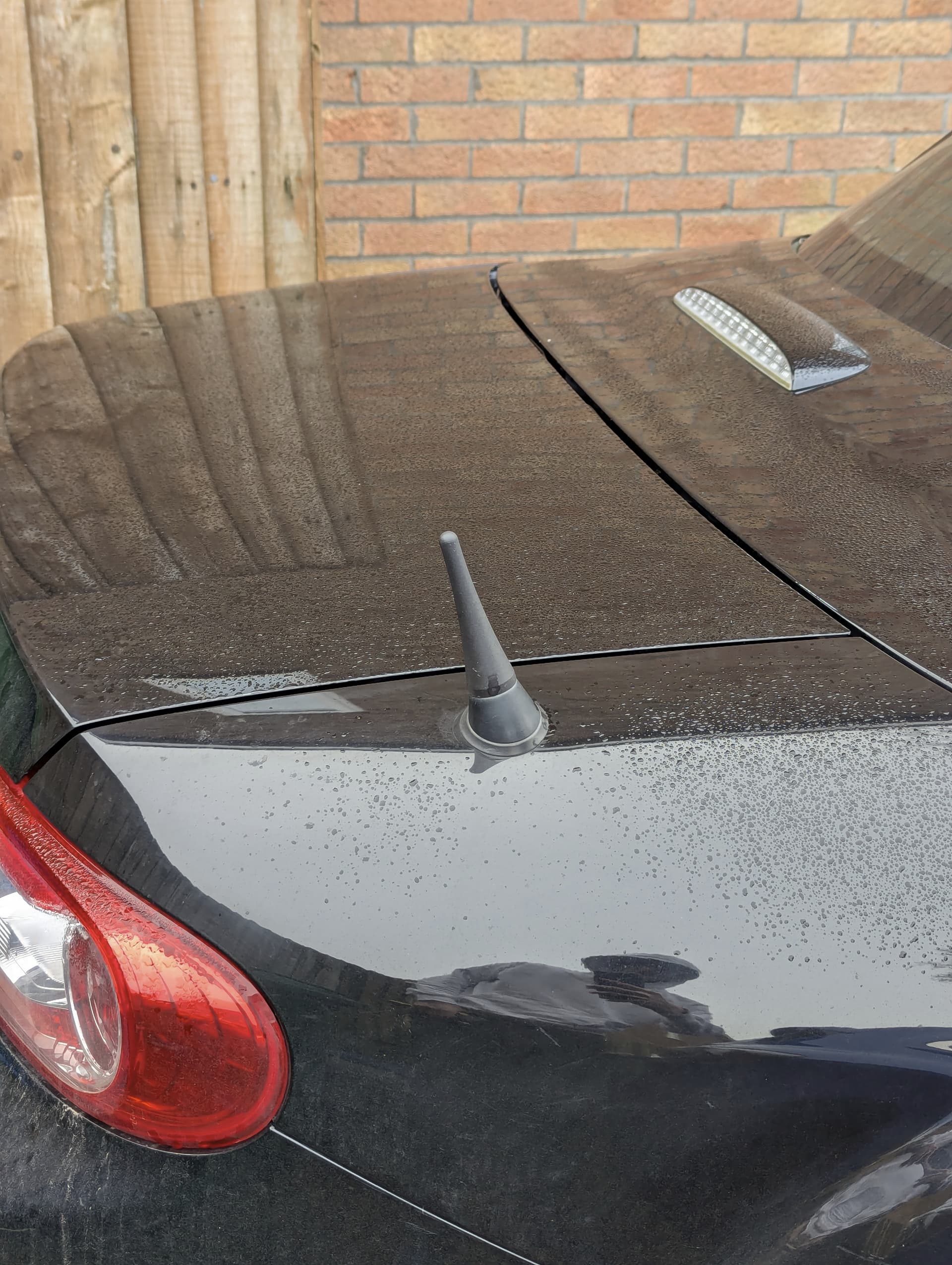

National stations dropped to 2 bars. Regional stations (BBC Radio Wales) was very poor reception. Put the Jass Performance Stubby aerial back on and got 3 bars signal and no dropouts.
That is helpful - thanks.
I’ll need to either get a stubby or replace the whole thing.
