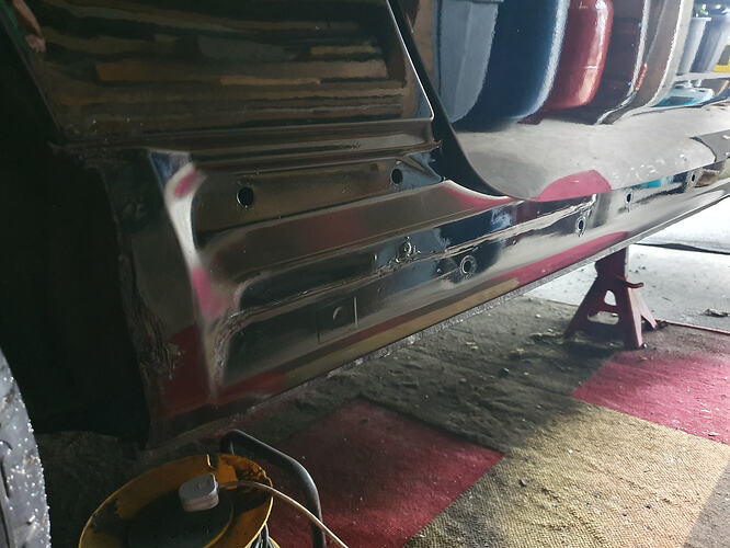

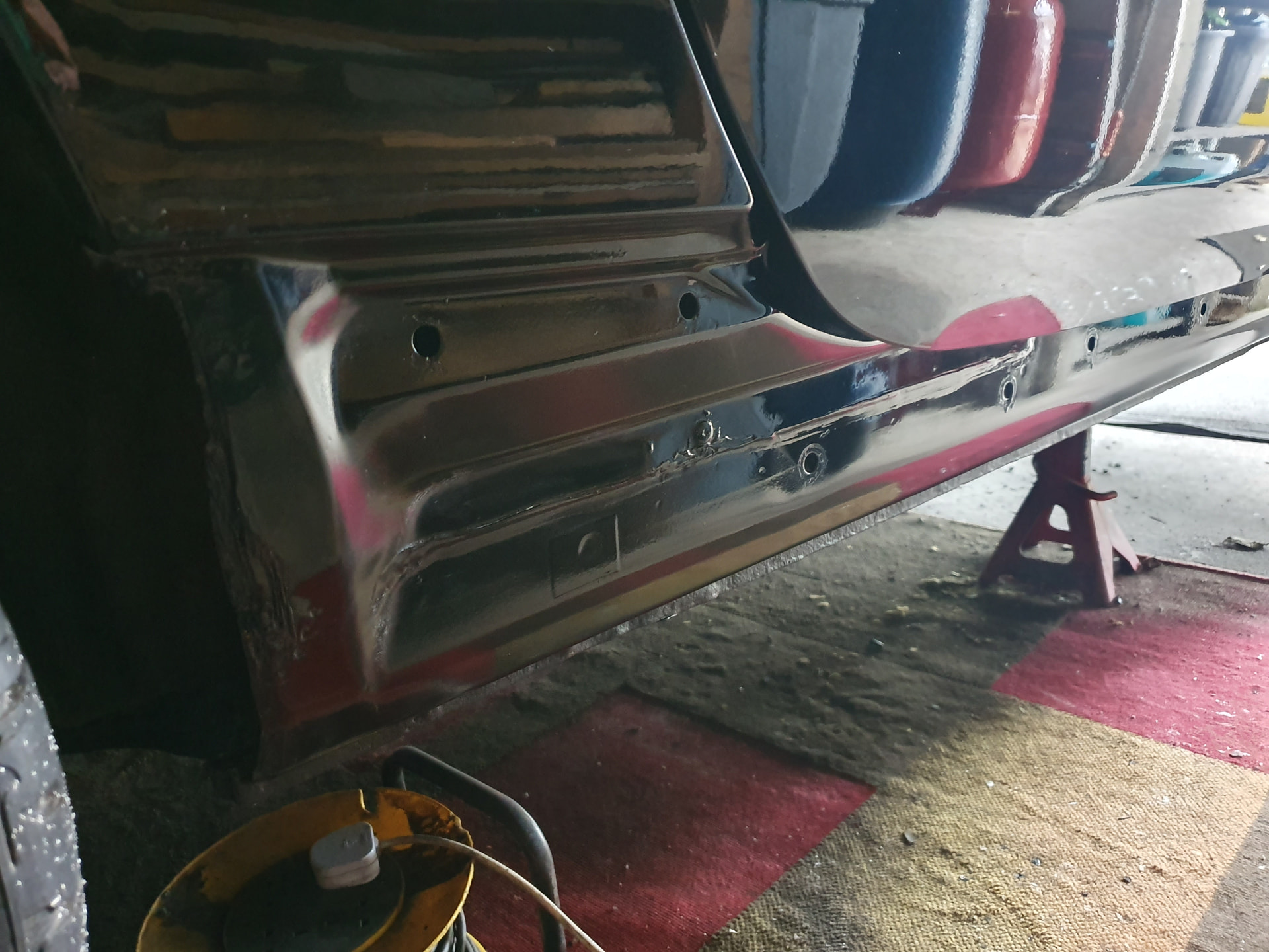

Took the side skirts off the NC ready for some inner sill preventative treatment and some outer sill cleanup.

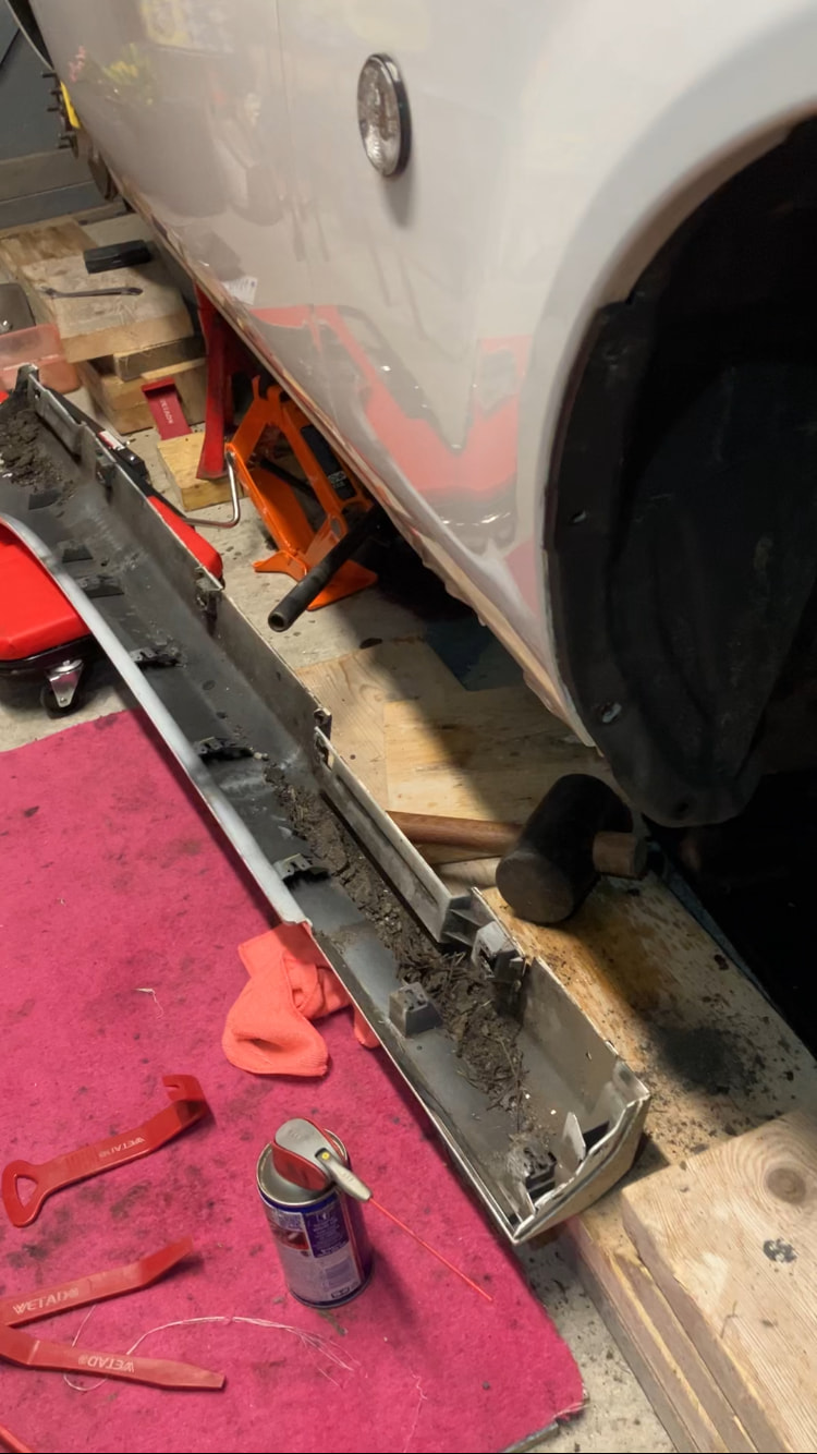

Discovered when doing the second one that in fact all the fastenings, except the end ones are slide fit. A lot of videos suggest breaking the clips is necessary-I’m not so sure now having taken them off . I think they just slide fit with a fastener either end.
The bottom larger clips are slide on/off, 5 per side. Push them into the metal sill and slide the plastic sill over over them. The small white or black clips are basically the same as door card popper clips, 10 per side. You place them in the holders in the plastic cover sill and once the sill has been slid in to place on lower clips these pop in to the 10 holes in the metal sill/body. Trouble with these 10 small clips they break for fun when the sill is removed.

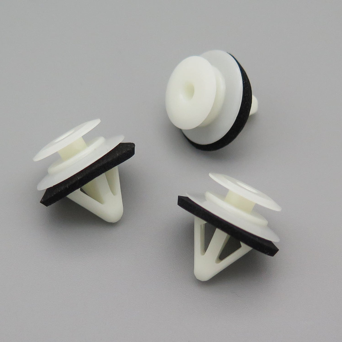

I used these on mine:
Excellent. Thank you.

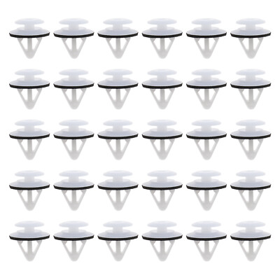

These below and they do for replacing the door card clips too.

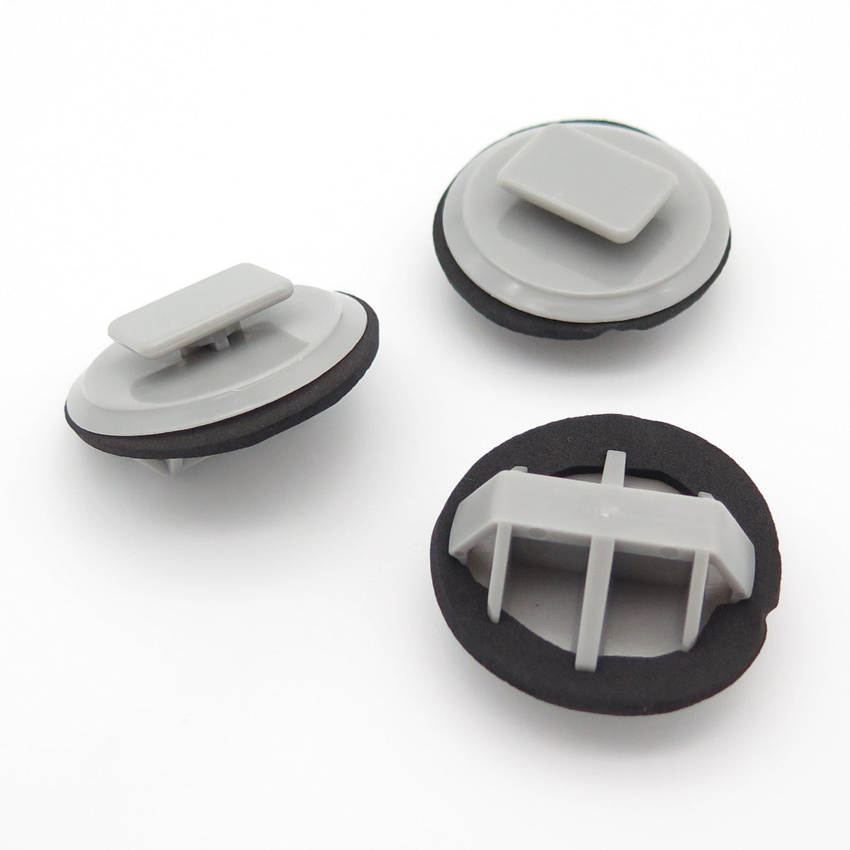

These if you need any lower larger sill clips, although I didn’t need to replace any of mine.
