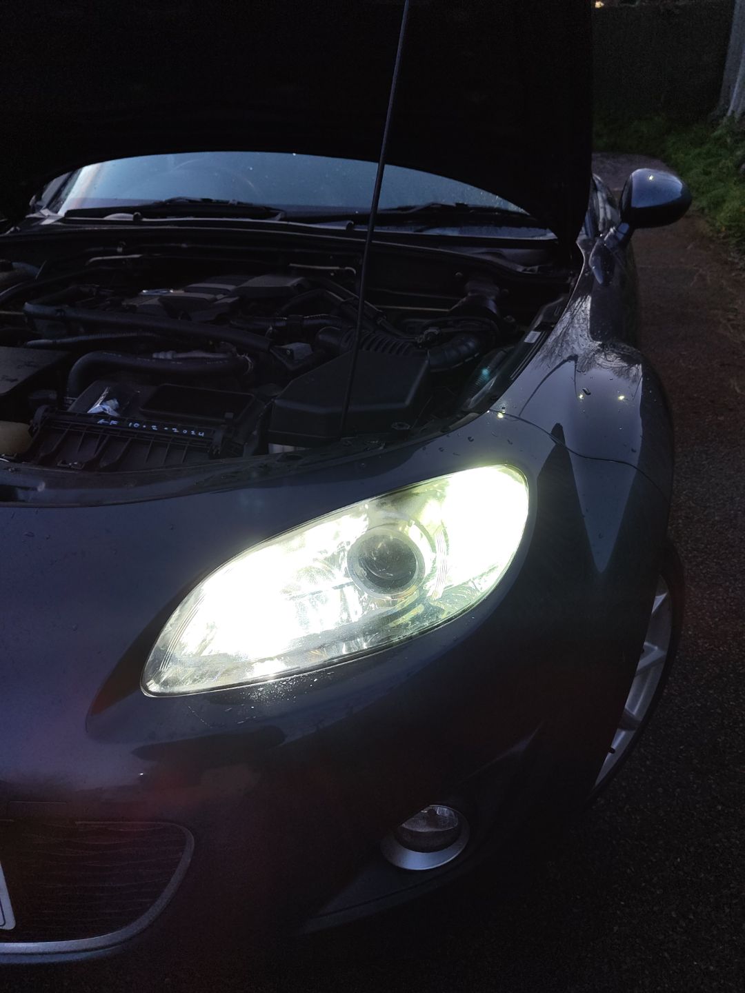

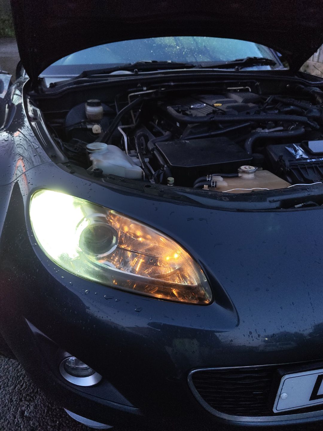

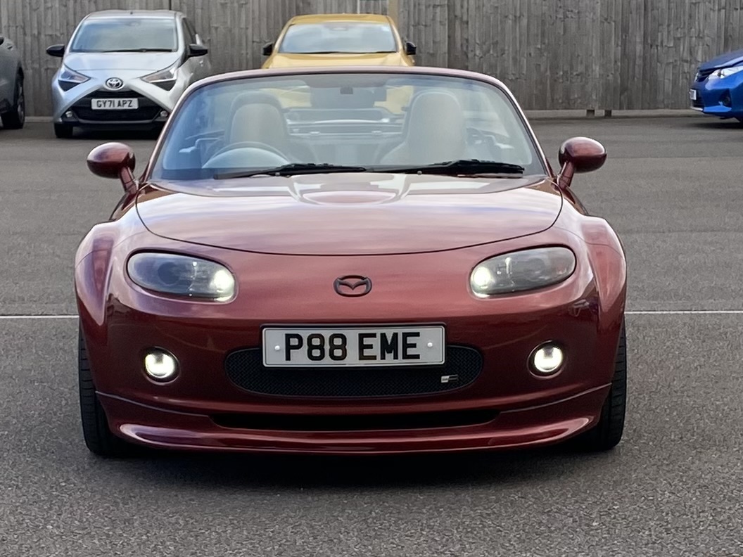

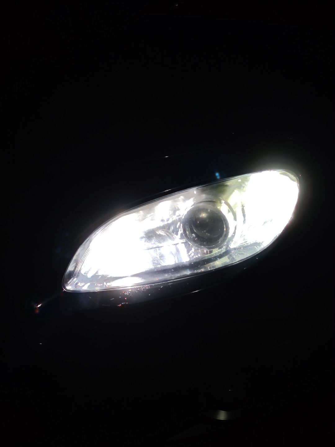

I got some cheapish high power LED ones from Amazon that just fit. Standard ones are T5 or T10 but I found some T15 reverse light replacement LEDs just fit my NC2. They’re BRIGHT! Here’s a photo:

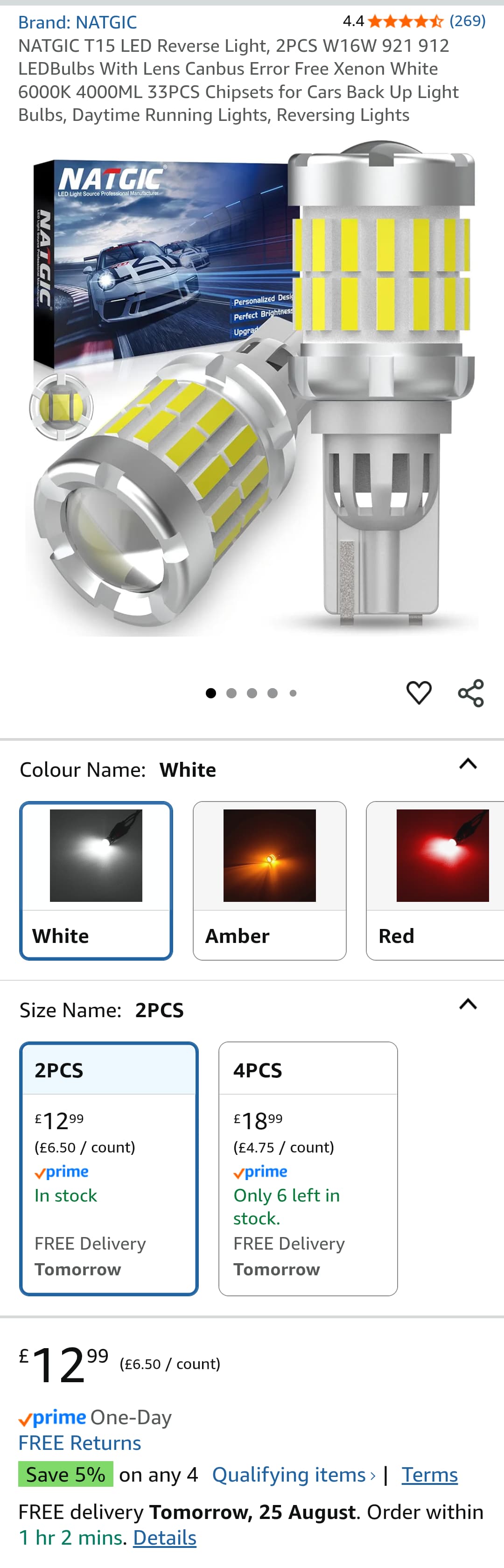

Here’s the type I bought:

These work GREAT as DRLs - but I already have the common switchback indicator LEDs.
Looks good, how/where did you get the switchback functionality? There is more to it than just plugging some bulbs in, doesn’t the wiring need altered/updated?
These look great, just worried they’ll fail a MOT
Mine passed no issues - it’s not technically road legal but the sidelights aren’t mentioned in the MOT guidelines, other than them working (if I remember correctly).
