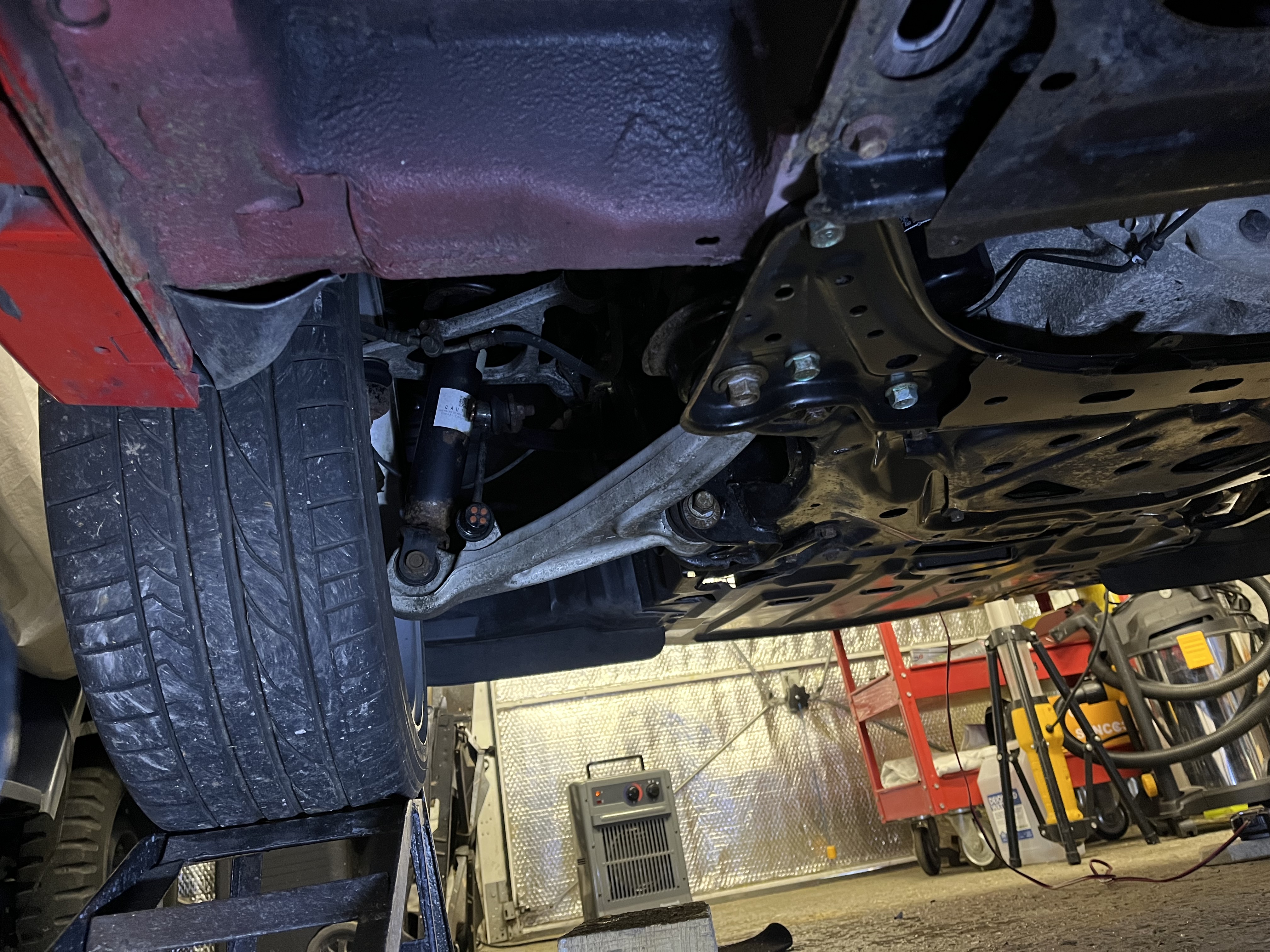

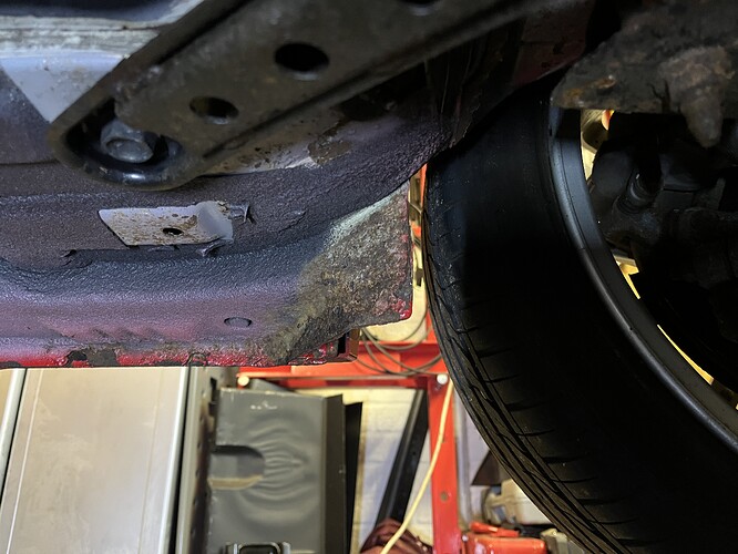

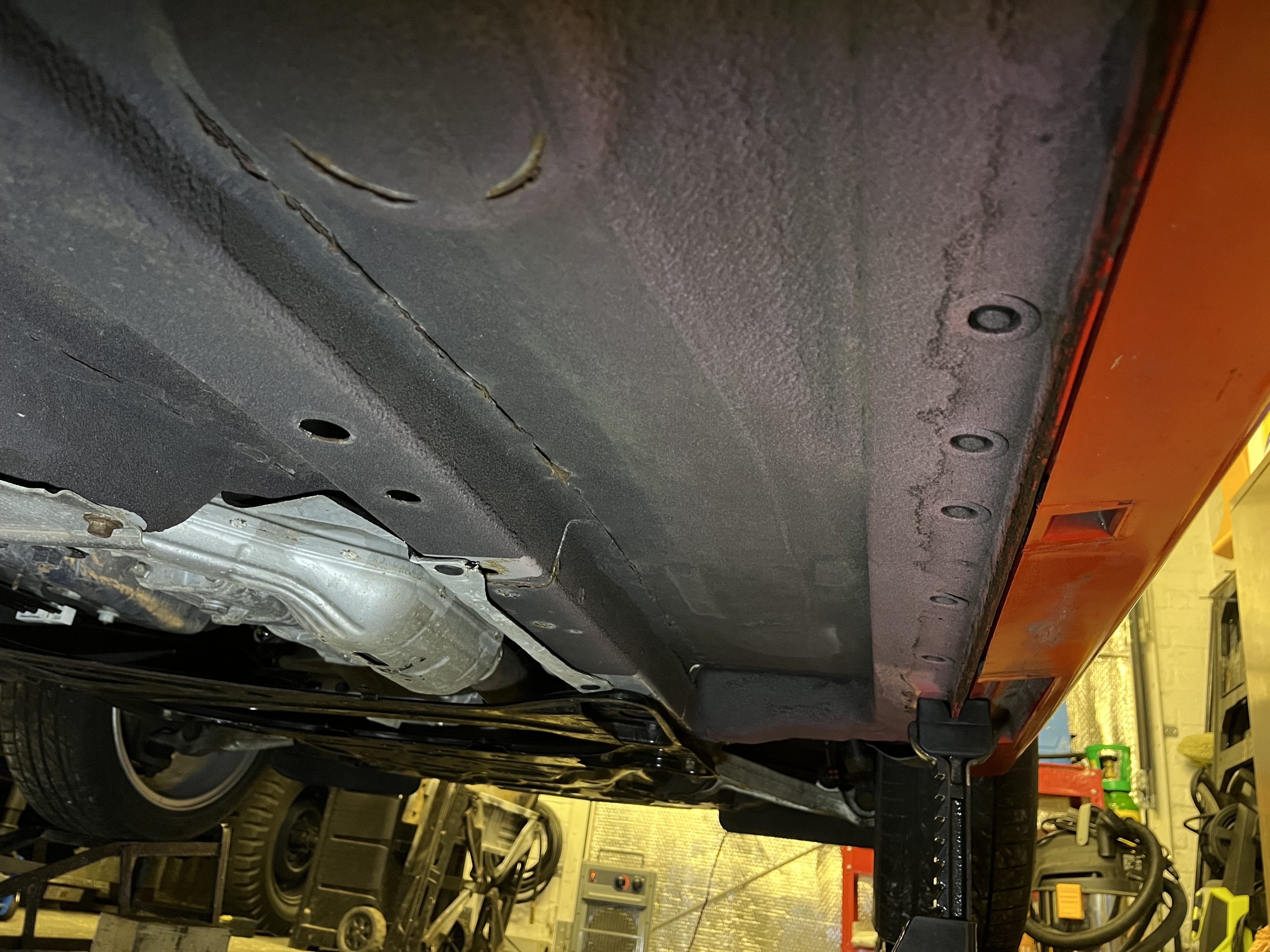

  4. In the summer I purchased 2011 Roadster with only 23000 miles on the clock. It is evident it has been well looked after by a club enthusiast. I’m in the process of removing/ treating visible rust underneath the vehicle. I’m using a rust converter, followed by primer, top coat & sealer.
  5. I have been looking at applying the rust converter inside sills & cavities. Is this idea sensible & how do I go about achieving this?
  6. The underside has been cleaned down. Can I access the sills to inject the rust converter by removing the ‘plastic plugs’ located underneath the sill, refer to photo? Or should I remove the plastic side skirts & interior door kick trim to access / use holes in sills above?
I’m not keen in filling the cavities with wax/oil, as should I later need to cut out & weld panels, I don’t want to worry about starting a fire!

Hi, 2 types of product to recommend, but its hard to see how they work as its all in the sill :laughing:
The first is a wax and a good one from all the times its been recommended to me, comes with a long 360 nozzle.
Dynax-S50 - Bilt Hamber
You can see it in action in my video at 19:05 into this video
Mazda MX5/Miata NC Mk3 - Maintenance Episode 4 - Rear subframe removal & Underside refurbishment
The other is cavity paint
Cavity Paint KIT BUZZWELD. Modifies, Stabilises, Halts rust- Lance & Seam Nozzle | eBay
Again you can see here at 6:16 into this video
Mazda MX5/Miata NC Mk3 - Maintenance Ep. 22 - Front Subframe Replacement & Rust fixing
At least 3 cans to do sides and rear
Buy a cheap endoscope from the likes of eBay. One which connects to the charging port on your phone. They are pretty cheap, and will give you a clear indication as to what’s going on in there.
You can get some access by pulling the internal sill kick plate off.

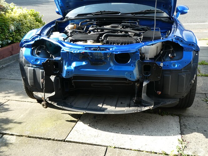

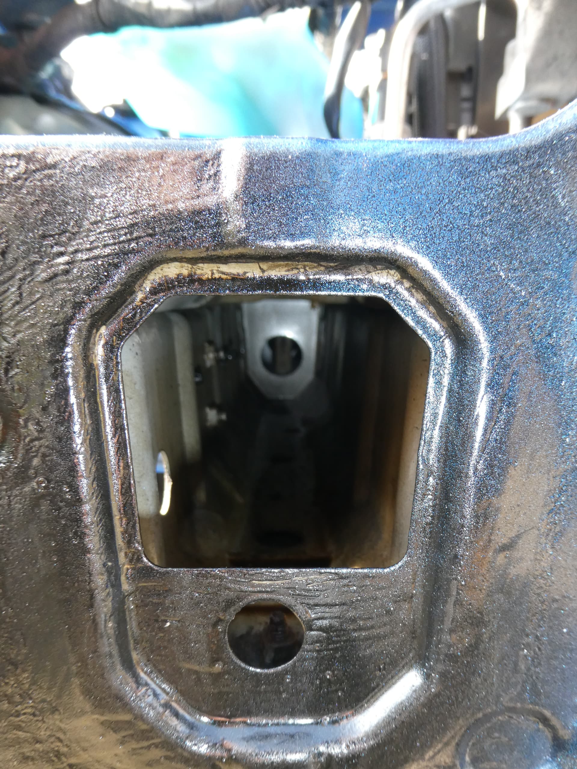

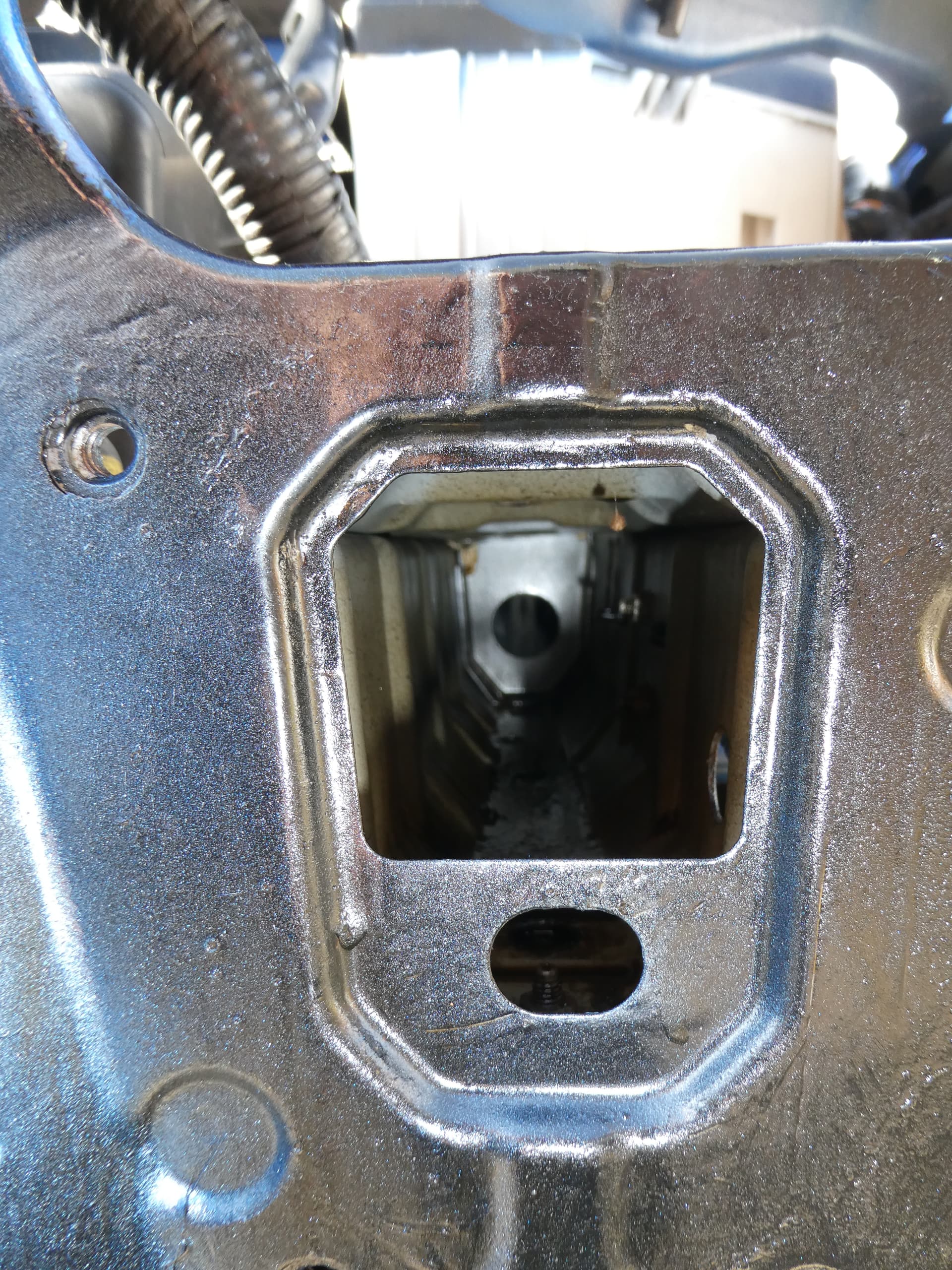

If you remove the front bumper and its support bar - you can easily treat the inside of the front chassis legs

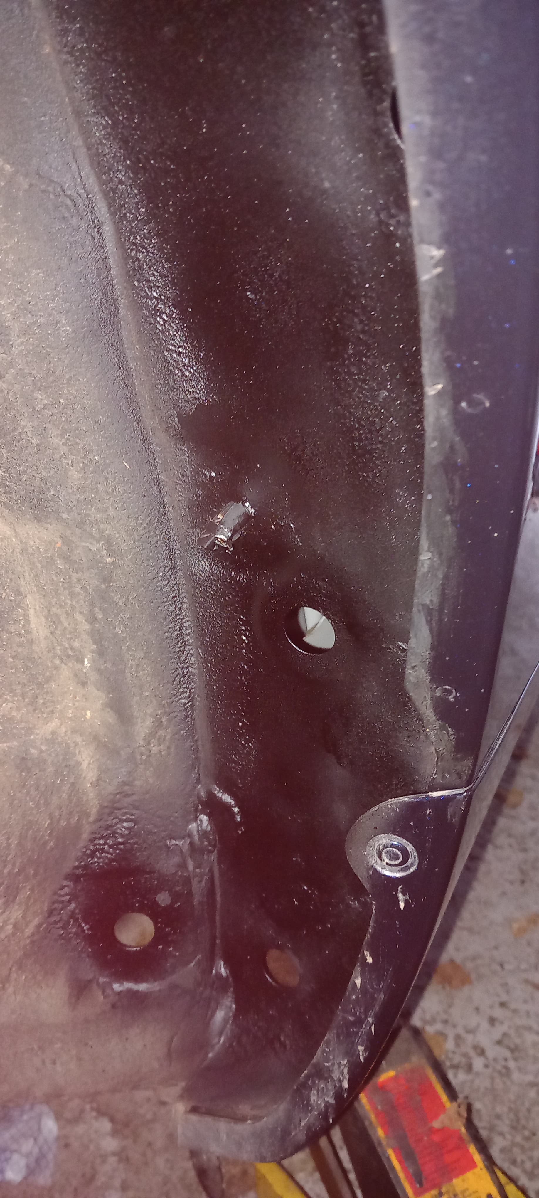

Remove the arch liners and grommets. Squirt Dinitol ML into cavities, the
extension hose is very good for this. Look closely at the bottom of this picture and you can see the rust . And if inclined do the area beside the seatbelts, second picture.
Thats what stops you needing to cut and weld surely? You could always wash the wax out with cellulose thinners :wink:
Seriously, the sills and any thin walled enclosed areas is where you need to attend to. Yes, the subframes can rot over time, but they are much thicker and replacements can be bought for less than the cost of a fancy silencer!
The sill work is skilled labour and appropriately seriously expensive. An endoscope and wax treatment with 360 degree distribution costs about £100. Every MX-5 deserves that.
