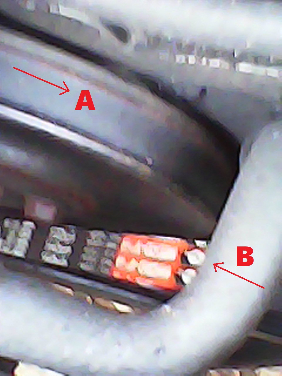

the other belt has just started screeching very occasionally. a different person i’ve spoken to has said this belt is for the alternator and i should change it. i’ve taken a picture. sorry it isnt very good. it looked really clear on my phone:
i thought it would be easy to see which was the new one, because of the printing on it, but the printing on the old one still looks pretty good. so, which is which?

Belt A runs the water pump and the alternator, belt B runs the power steering and the air conditioning. Belt B certainly looks like the new one. The length of belt A is the same on all NA MX-5/Roadster. The length of belt B changes depending on if either or PAS or A/C is fitted.
