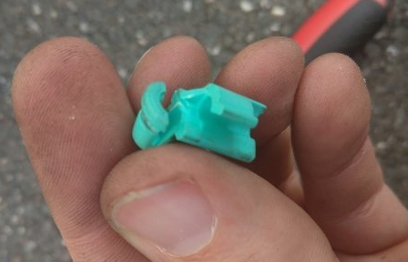

When my central locking played up a couple of years ago (on my 2013 NC 3.75) it turned out to be the door lock actuator.
Not a cheap part https://www.mx5parts.co.uk/door-latch-actuator-assembly-mk3-35-15223
I found excellent instructions to replace it on pistonheads
https://www.pistonheads.com/gassing/topic.asp?h=0&f=185&t=1776849
OH and I seem to remember this green clip doesn’t come with the new actuator so be careful not to break / lose it!!
