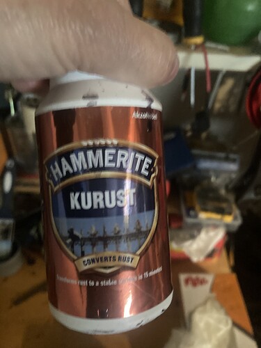

I had exactly this, noticed it last summer. One spot only, same place.
Removed all the mud from the inner arch- to avoid providing an area likely to contribute to dampness/corrosion.
Then ‘burst the bubble’ of paint and cleaned/sanded the area-smaller than the top of a pencil. Painted it with rust converter, then a spot of primer, then paint.
No further issues, no progression, and have continued to try and keep the inner arches free of mud.
I was hoping it was due to maybe a stone chip hitting the inner arch rim, as opposed to rust from within ( caused by the wet mud stuck in the wheel arch). We live in hope.

Wow … sounds the same issue, thank you for replaying I just found it on amazon I bought it . Hopefully will be ok , I think you right have to keep the wheel arches clean of mud and hope for the best .

The arch liners come off easy enough, clean them down (jet wash) and do the arches whilst off. Treat any rust with something like pictured above and paint some underseal under there before refitting the arch liners.
As for the rust bubble just use a touch up paint (get the Mazda official paint in colour) after first treating with a rust converter, again the stuff pictured above, use a primer then finish in colour, probably more than one coat each.:+1:
