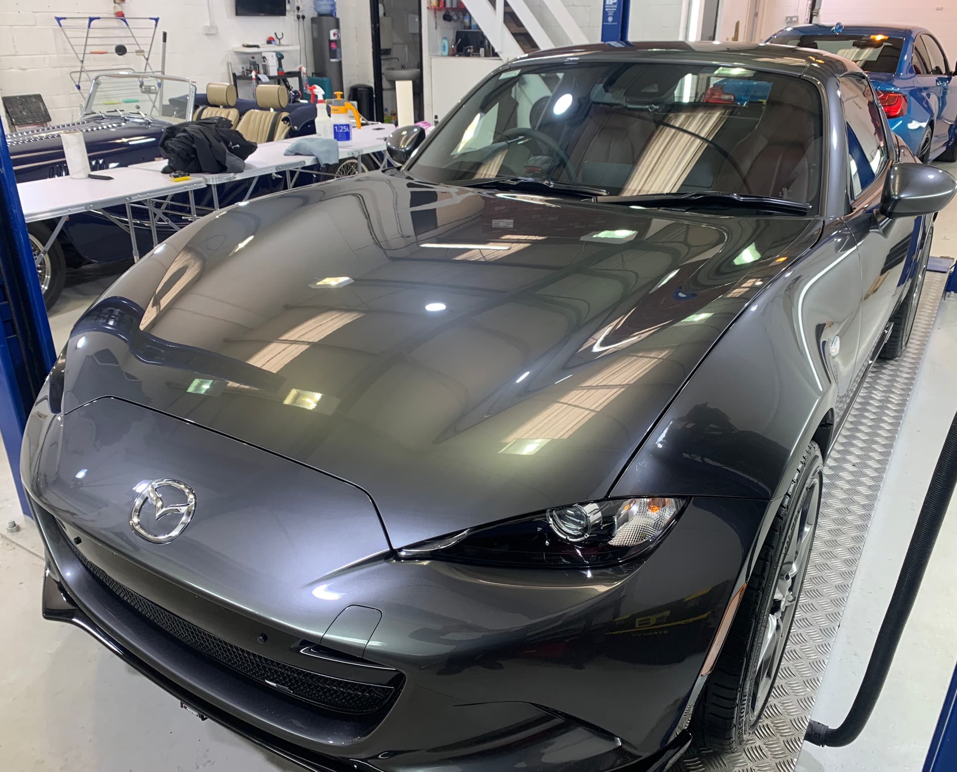

Once you sorted the paint out, I would recommend you getting 3M clear plastic paint protection film and a ceramic coat had my car almost 3 years not a stone chip on her …
Its well worth the money and she has no swirl marks on her either

For the full front end and around the windscreen with both mirrors black roof bar on my RF with the side blackouts and Ceramic coating and a one ltr bottle of ceramic spray for after washing was under £300.00 its been well worth it “I had my RX~8 done no chips on the front end after 13 years” …

whooo thats expensive my RX~8 full cover was only £470.00 mind you that was 14 years ago and ppl has come along way since then its all about personal choice and if you can afford it ………
I find that price rather hard to believe. PPF material and the relevant skilled labour are quite expensive. I’ve had quotes for Suntek, Xpel and PremiumShield varying from £1,000 to £1,500 for the frontend which the figure mentioned by @glosrich falls within. To have the whole car done including painted roof, it can vary from £2,500 to £3,000.

If it was me with new car depending on how long your going to keep it i would do the ceramic coating and PPF shop around a good company will do it properly in two to 3 days for the full car including wheels……
i had a quote yesterday as i needed a top up bottle of ceramic spray from the people l deal with as a first time customer its £580.00 for the complete car and they have it around 2-3 days …….the reason it was so cheep for me was we have had our 3 cars done by them ……mates rates so to speak
