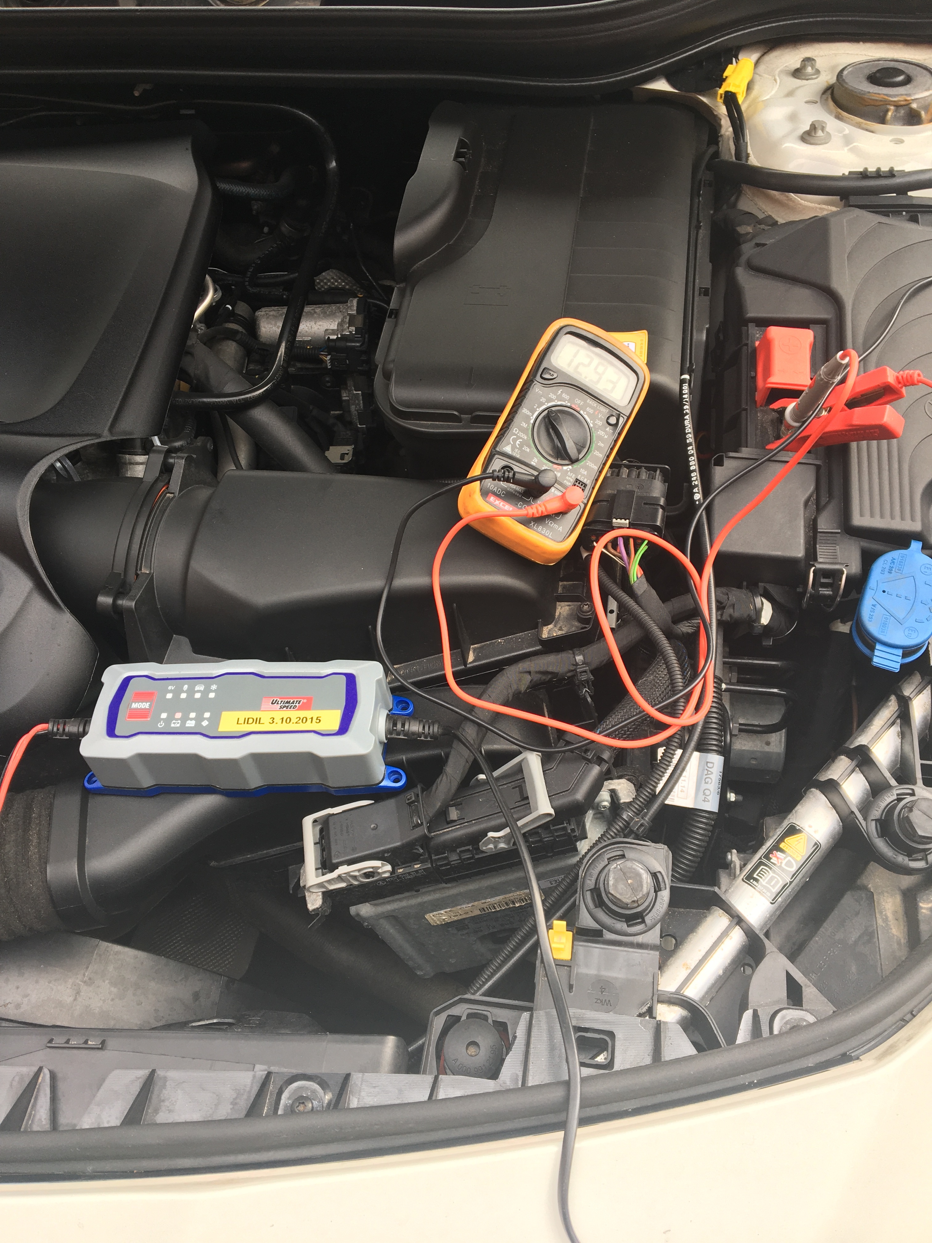

One of my smart chargers in use today on my Sonâs Mercedes with stop/start technology.
Lidl special over four years old, the one on the MX5 is a Numax which has been permanently connected for over six months now.
