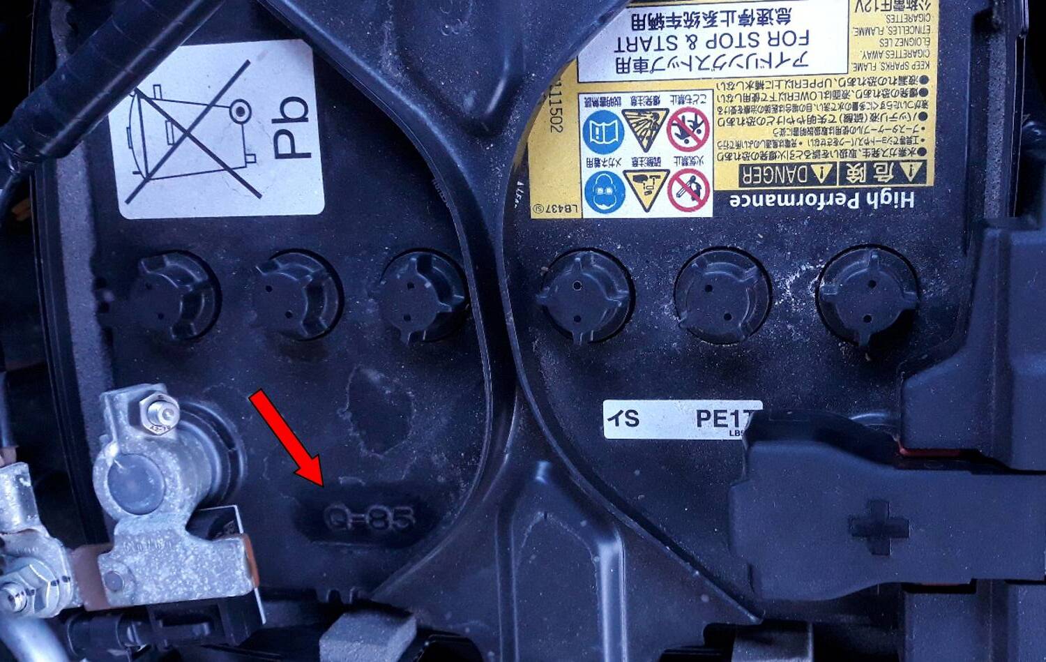

Your (presumed) Q85 battery is an EFB with 65Ah capacity, for Stop/Start In other words it’s an ordinary lead-acid battery with mechanical improvements to cope with a higher duty cycle. There should be raised letters on the top near the negative terminal to identify it, a torch can be useful to see black on black.

I did take a note of all markings on the batteries before starting this post and yes the Mazda 3 is a Q85. Thanks for confirming it is an EFB 65Ah. Good to know for when it is time to replace it.
