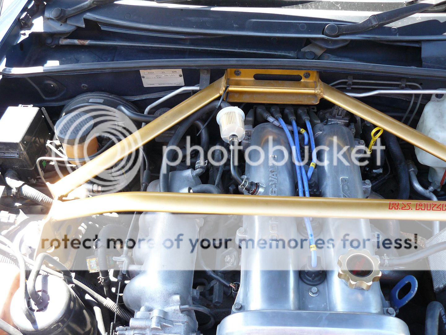

After the engine was swapped, I got the mechanic to pull the head off the old engine (mainly because I wanted the head). It was pretty clear all was not well with number 1. The car was using massive amounts of oil by the end; 1-1.5 liters per 1000 miles or so. 200k kms on that engine (1996, so higher compression version). The engine was probably very repairable, but not on my wallet.
But, despite all that, the car drove very well. Like other people with the same problem, compressions were well within spec. Have a read of this, which goes into it more, and discusses some last ditch engine cleaning treatments (which don’t really work):
http://forum.miata.net/vb/showthread.php?t=461565&highlight=oil+control+rings
I had heavy oil consumption before I noticed the smoke; the smoke being white, maybe at first I just thought it was just steam, on a cold morning start, because it always went away pretty quickly. Then all of a sudden the smoking became clown car like.

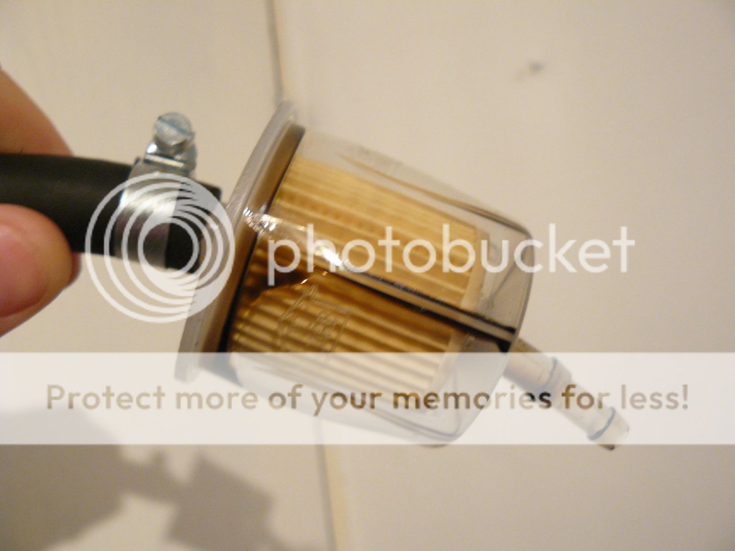

I tried all sorts of experiments to try and work out where the oil was going (with less than 200k kms on the clock, you don’t really expect the motor to be worn out). A defective PCV valve was mentioned, or crank case pressurisation. So I set up a line, with a clear fuel filter, between the camcover and the inlet manifold. Although some oil was trapped there, nowhere near enough to explain the oil consumption.
I suspect sticky or worn out oil control rings. I had this problem with mine (see Smokey Start Up somewhere in this section about 5 months ago). The smoke  probably disappears after a couple of minutes because the catalytic converter has heated up and is now mopping up the smoke - although the engine is still producing it. Eventually the cat stopped working on mine and I became a portable fog machine. My oil consumption was also horrendous. Opinions differ on the rebuild/second hand engine route. You need to know the condition of a second hand unit or you might have the same problems all over again.
