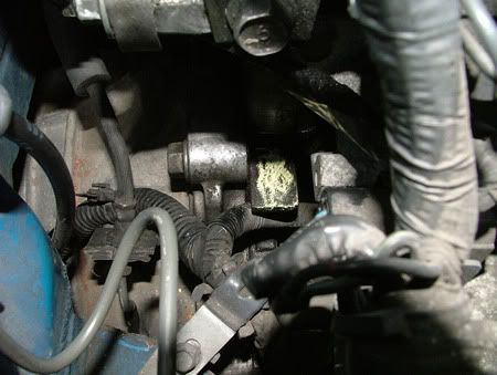

Here’s the location on a 1.6, the 1.8 engine number is on the exhaust side, in the same location—
The first pic just shows general location
The second one shows the engine number marked with yellow chalk

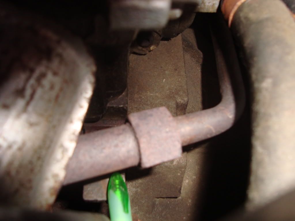

This is where the engines numbers are located on both the MK1 and MK2 1.8 engines (NA and NB series).  I cannot authoritively say if it is the same on the MK2.5 or Mk3.
http://i865.photobucket.com/albums/ab216/kempy2525/DSC00628.jpg - the engine number is near here on 1.8 engines (exhaust manifold side) and the opposite side apparently for 1.6 engines (intake manifold side).  I recruited some help in trying to find the damn engine number!
http://i865.photobucket.com/albums/ab216/kempy2525/DSC00630.jpg - remove the dipstick and it is basically located behind there (see green pen).  The block may be a bit rusty so what I used was a pair of thin nosed pliers with sand paper or emery paper (not too coarse).  Wrap it around the nose of the pliers and clip shut so it does not fall off.  Approach the block under the heater hoses where they go into the bulkhead and gently rub the top of the surface of the block (try not to score the block with the end of the metal pliers).  It is a small piece of metal about 1.5 cm wide and 3 cm long.  The engine number is stamped into the top (the bit facing the underside of the bonnet).  Keep checking your work and you may find you can read the numbers easier if you do not shine the torch directly at the chassis number.
