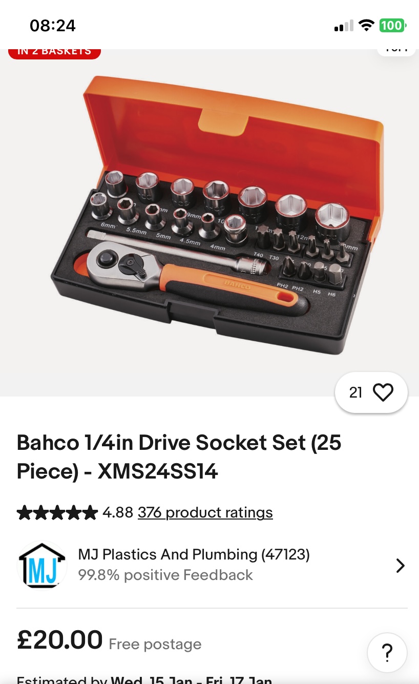

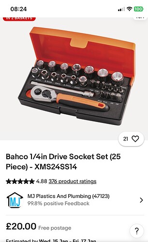

Best £20 you can spend for getting in to tight spaces in engine bay , under dash etc

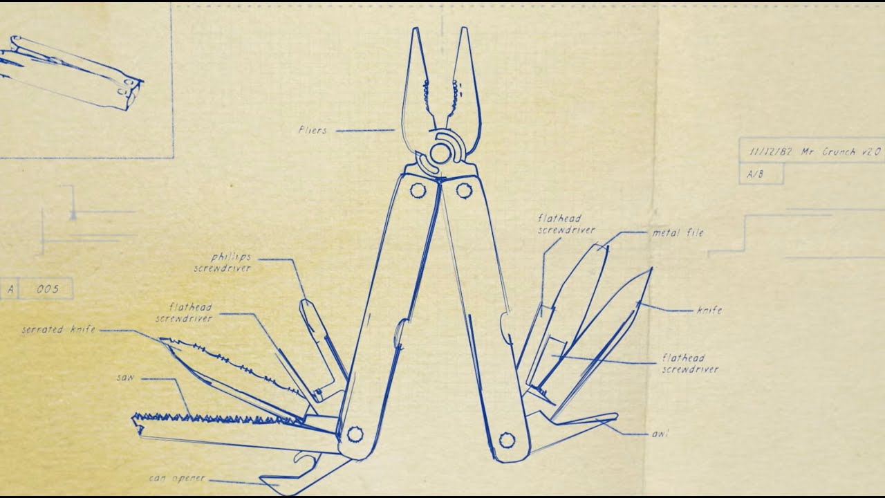

And get a Leatherman. I have an ancient Supertool that has served me well fr 30 years. I used to have an original PST, but that’s disappeared. My Supertool is the best tool I have. It never goes in the tool box. There are imitators, but I think none are as good, ultimately, as that Supertool. The Leatherman story is the stuff of legends, and it started with a beat up Fiat.
While its not saved my life, its certainly saved my bacon on a few occasions. The top of the bone saw broke years ago, and although it has a lifetime warranty, I’m worried the UK agent will just bin it and give me a credit on a new Leatherman, rather than fix my Leatherman.
