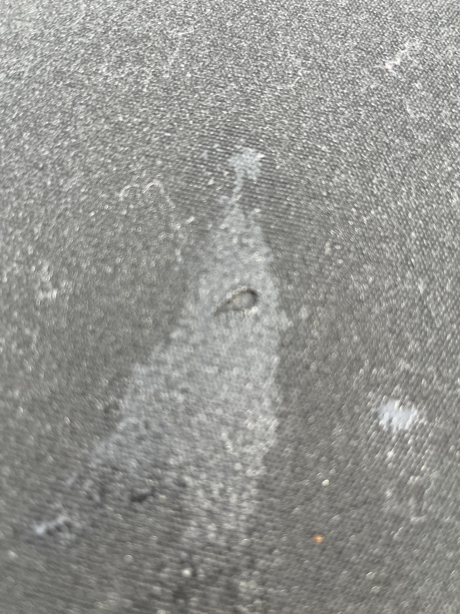

Don’t mean to hijack but am very interested and the right sort of local too if a repair is required.
Mine appears to have damage to the outer canvas but doesn’t seem to leak - is there a rubber lining to it then underneath this apparent hole?
Not really
But buy Stormsure - Waterproof Repair Adhesive 15g from Amazon
Yes, there is an EPDM layer which is the waterproofing bit. The woven outer layer makes it look good and provides some protection against normal abrasion and sun. There is also a woven inner layer which once agin provides abrasion protection and looks better than a plain rubber surface. If the EPDM layer is still intact then the hood should not leak.
Little trick when using the adhesive.
Get some plasticine or bluetac
Press it against a good part of the hood so it picks up the material pattern.
Then as the glue is going off - press the bluetac/placticine against the repair so it takes up the pattern.
