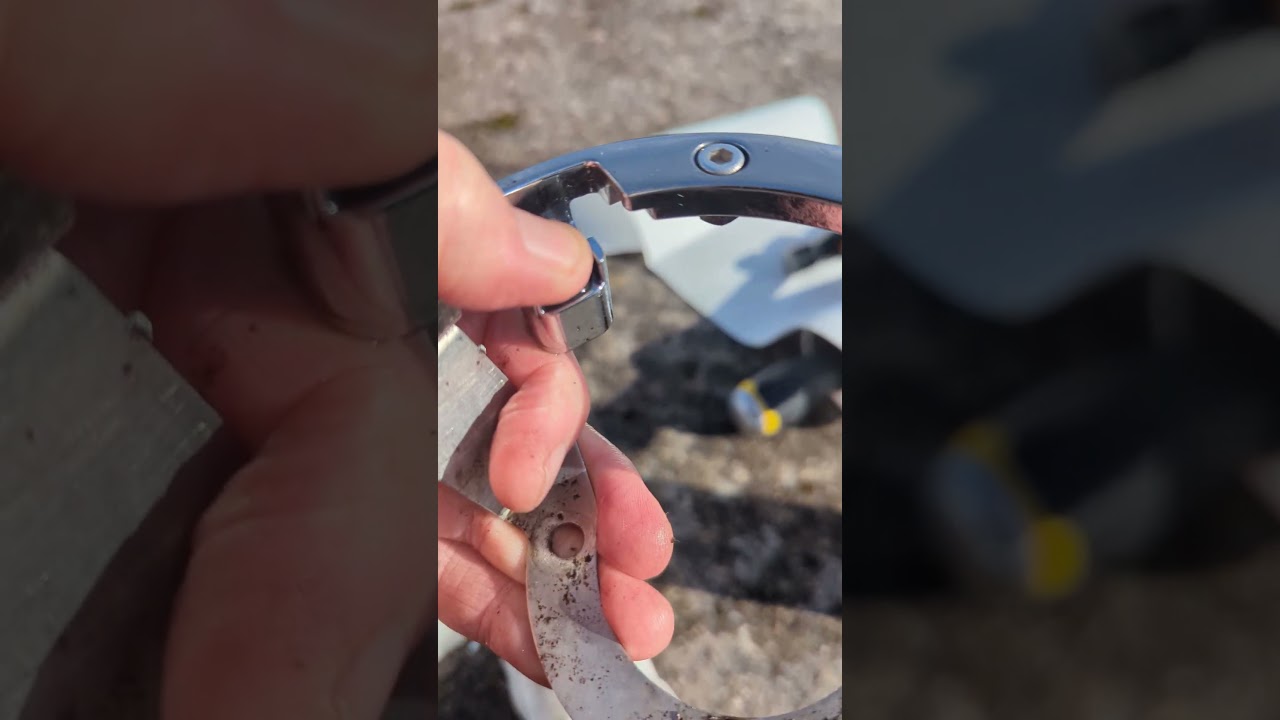

the ‘spring’ is a piece of metal on the opening side (opposite hinges) that pushes the cap open. it is a fairly straight length so can be adjusted/bent to be closer to the cap. I can attempt to post a photo of this tomorrow if it will help.
Hi Jitsuka,
If the photo uploaded correctly, this is the “spring” - flat piece of metal shown between the two holes, that pushes the lid open. It can easily be bent further upwards. I hope this helps.
