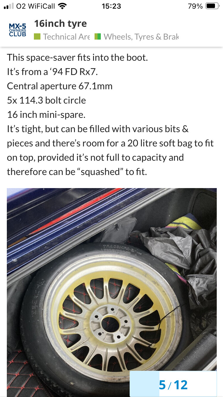

This is my Enkei alloy spacesaver off the Rx7
No LSD in my 1.8 SE NC, so can use spare front or rear.
