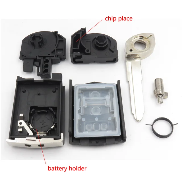

The chip (a little black device) sits in the tiny space to the left of the key mechanism in the top part of the remote unit.
Although this is not an Identical key, the picture below is pretty accurate

Good pic Harco - I was looking for similar but it somehow eluded me. You can see that the chip housing is close to the top of the key blade and as central as it can be.
There are probably variants on this as several MK3 fob types but similar idea.
