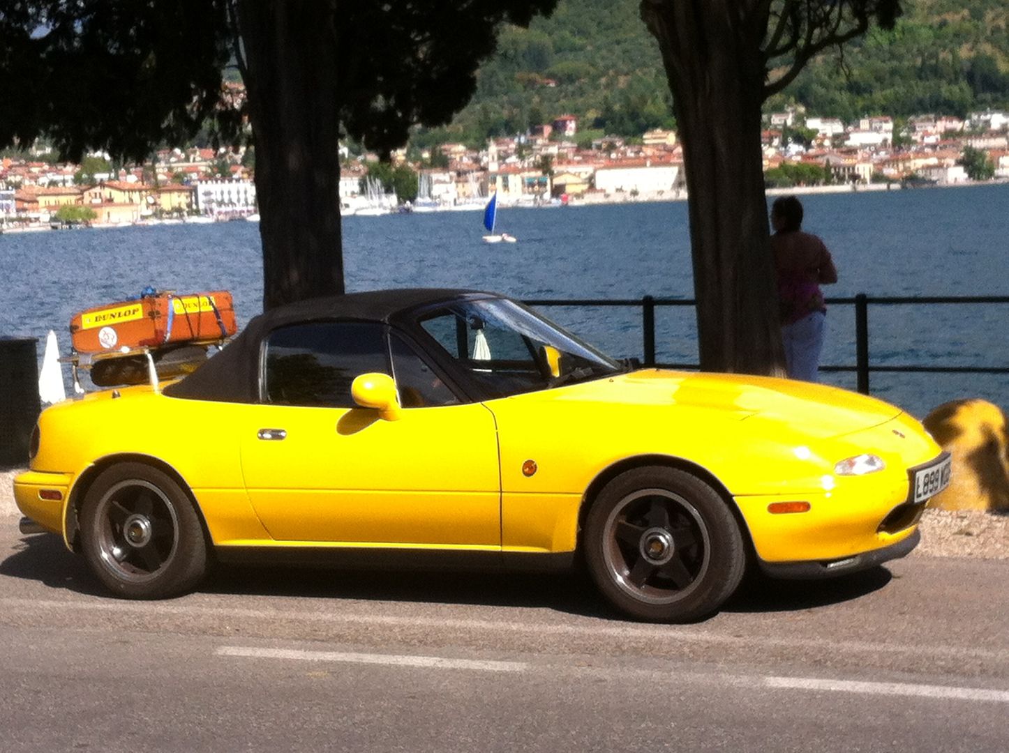

Wrong! It worked really well and actually looked a bit Monte Carlo or Bust but it allowed two of us ten days worth of clothes ect for a trip to Italy. I even filled the spare wheel with spare parts and made a lid for it held down with magnets…
Actually, because of the way the boot hinges work the extra weight actually helps the lit stay up when open as the centre of the mass is ahead of the hinge line.
The bootlid is a spare one painted in yellow aerosol and the additional legs for the bootrack were machined and tapped from billet aero-grade aluminium alloy and bolted through the bootlid and using studs are threaded into the bottom of the rack`s original feet in addition to the 2x8mm stainless threaded bars and heavy grade stainless side brackets.
Lastly an uprated rear anti-roll-bar was installed to counteract the change in CofG
It was good for at least 120mph, and of course the first rule of Italian motoring : “What isa behind you is not importante”
It can work…
I covered 2000 miles in a week through the UK like this on an H4H trip without any difficulty. It may look flimsy but in fact the rack was double-grab bracketed , and you cannot see the custom cut steel plate through which a thick bolt secured the (very lightweight) 14" alloy. I just used little wooden pole to prop the lid up…no worries.
