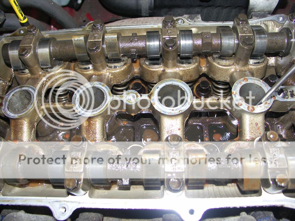

Cam cover removed and found water in the cam cover. hopefully posted a picture below.
water in cam cover
Do others agree??

This time with photo hopefully. Yep sucess!
I was going to say that stuck spark plug leads could be caused by overheating, I’ve seen the leads melt themselves to the head/plugs. This coupled with your watery oil could well indicate head gasket failure, from experience the head has probably warped though so get it flat checked before refitting. If it has wrapped, give the valves a good lapping in too.
Rusty looking water, not looking good that.

Gary has already said that there is water in two of the cylinders - it is regrettably clearly more serious than condensation.
Add the compression test results and there can be little doubt in my opinion.
Head gasket failure usually means water in the oil but not always - it depends where the gasket has been breached.

M-m, no signs of oil in the water. No signs of emulsified oil in the than cam cover or dip stick.
