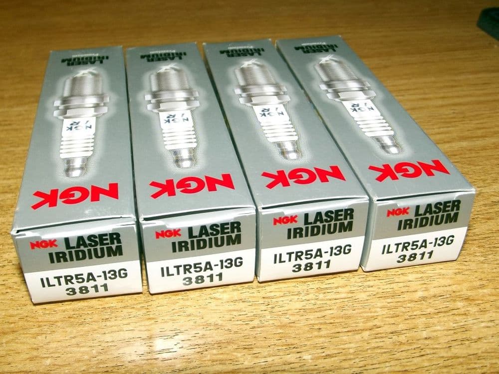

Hi, and thanks for your initial response. Might have a look at the condition/cleanliness (or otherwise) of the mass air flow sensor. Re plugs, which would you go for on these choices??
I’m going to order the above plugs before spring comes around.

Took a look at options you linked.
Now I may be wrong and I’m happy to put right on this one by members…but I believe Iridium plugs are the
‘required’ choice for both 1.8 & 2.0 variants.

Thank you for the link. Just had a word with a guy there and he says can’t get hold of the NGK iridium plugs suitable for the 1.8 engine for love nor money! He did suggest calling Euro Car parts. Have looked on their website and, not surprisingly, they list a handful of different makes but do have the NGK Iridiums at £21.99 per plug. (with NGK trade/part number of TR5AI-13). They have various Denso ones and a cheapy Bosch one for under £10 a plug. On each one, they have a drop-down ‘fitment detail’ tab, which includes the engine code. The NGK plugs I mention above show L8 as the engine code - is that right for the 1.8 engine in my vehicle?

I fitted NGK TR5AI-13 to my NC 1.8
