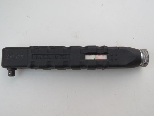

Rahsol Dremometer 1

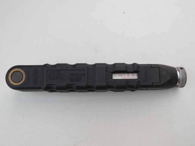

 Rahsol Dremometer 2
