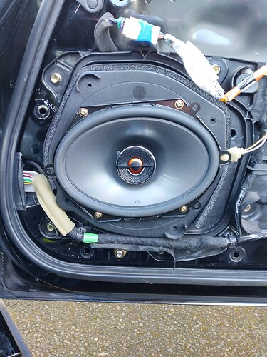

JBL GX862… Bought a pair of these and they fit straight onto original screw locations in the door.

JBL GX862… Fitted to original screw locations, no adapter plate needed.
Sound pretty darn good even with original non Bose head unit still in situ
Bought mk1 Ford Focus speaker connectors online for £5 a pair, this enables you to still use original Mazda speaker loom
