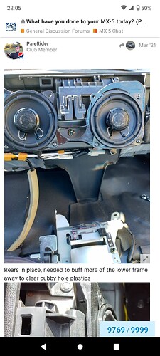

The original speakers are pretty poor , I fitted larger but needed to make a frame to sit them in.
Space is at a premium back there.
