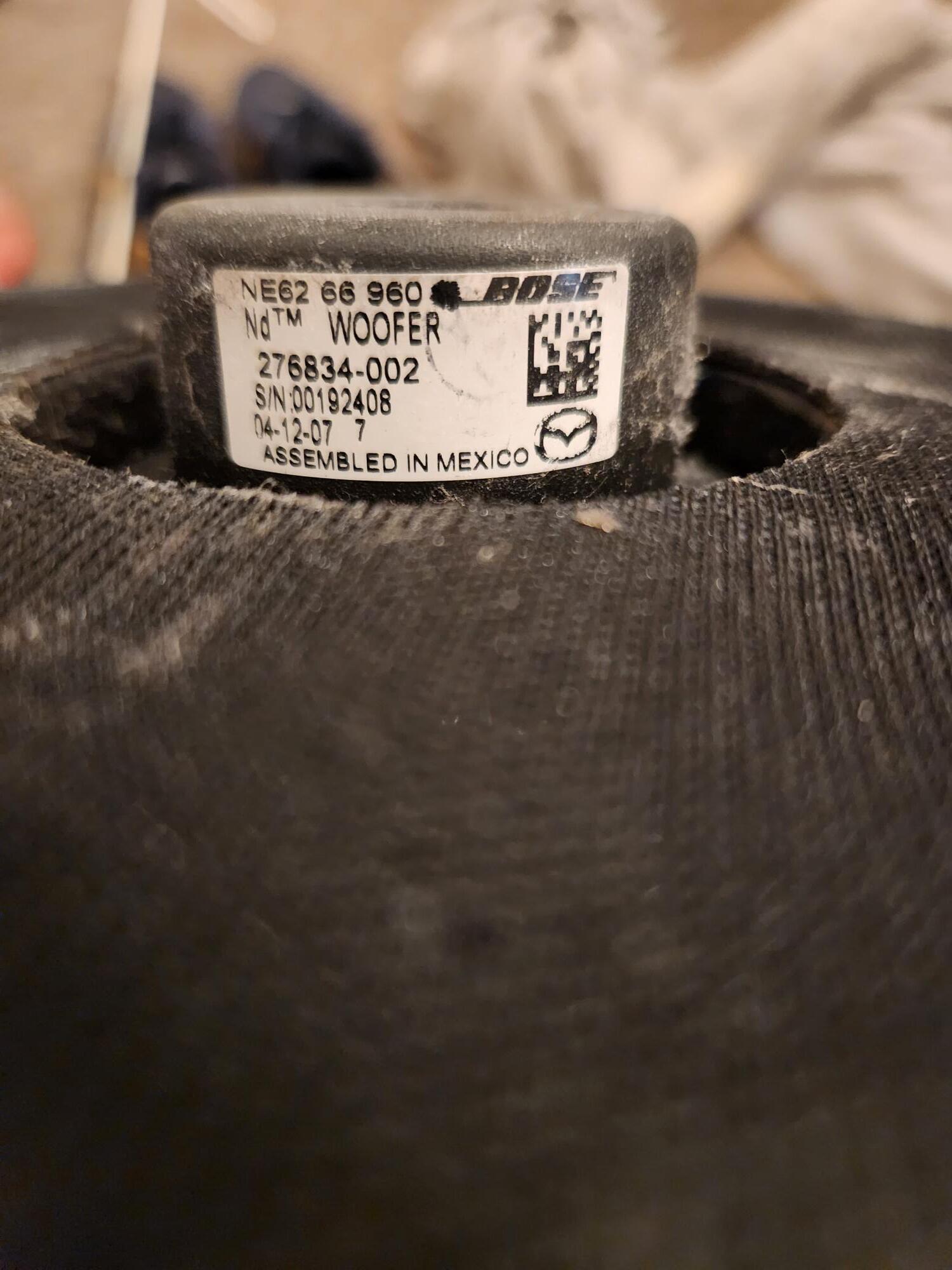

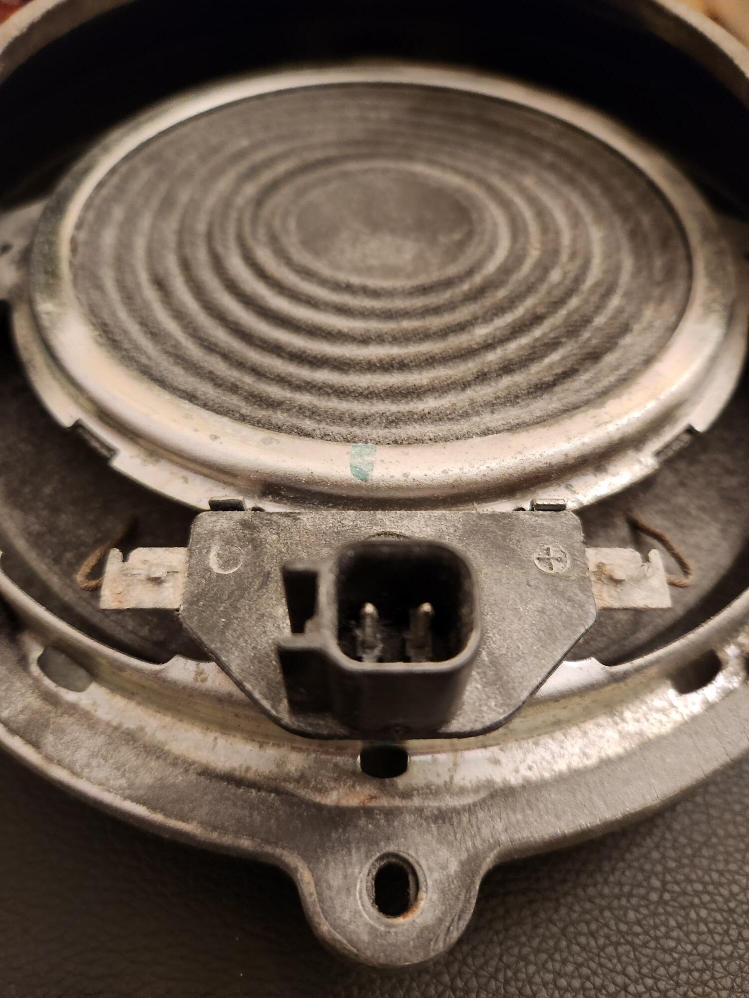

my sport tech has the bose system and the right door speaker was blown when i got it.
i looked at after market options but it seems to fit and after market you havee to start cutiing things and theres no adaptor rings avaible to avoid cutting.
i eventually found a pair of bose door speakers on ebay! that had been salvaged from a scrap bose nc!
paid like £50 for a pair.
i can post a picture of the spare one if that will help you find the correct replacment as there are 2 types of door speaker for the nc (bose, non bose) and people on ebay dont always label things correctly

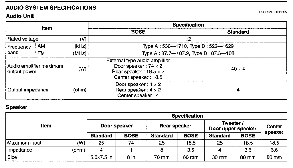

The Bose system has 200mm round bass speakers with separate tweeters.
Non bose has 7 x 5 oval bass speakers with separate tweeters
For the Bose system
The only speakers that seem to be recommended are the Focal ISU200
The bass speaker is the correct fit but you need to make a small bracket to get the tweeter in place.
NOTE - the Bose speakers are only 2ohm speakers - all aftermarket are 4ohm
Any 4ohm speaker is going to sound quieter than a 2ohm speaker at the same volume setting

Hi Thibor , thanks for above , never easy , yes if you could send me a photo of the one you have , that would be great . Thanks
