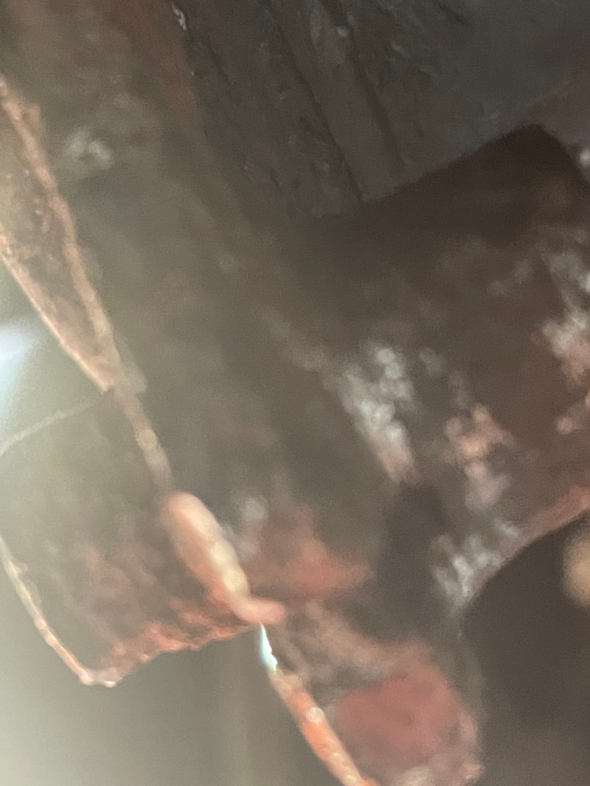

I’ve tried the WD40 Penatrting fluid - no joy - so I’m about halfway through sawing off one bolt, looks like there’s a flange gasket, so If I can get that moving it should (hopefully) make getting the other one off - though think that’ll need cut off as well, to be honest. Hoping for a dry Saturday - not so sure about the Sunday - want to watch the footie

These seem more like they’ve welded themselves on over time. I’m about halfway through one of them and it looks like there’s an oval flange gasket, hopefully once one is off, wiggling the gasket just might make the other easier to get off, but I honestly doubt it.
So it appears that the second nut is a castellated nut, but the bolt seems to have been welded on - neighbour has lent me a grinder, so tomorrow cutting the bolt bit off, and then (hopefully) I’ll be able to knock it through!
Also still to clean off the remains of the old crush gasket and the flange from the central pipe has lost a bit of itself to rust - probably use some gun gum if I need to make up any leaky hole - just can’t face replacing the centre pipe just now - maybe in the summer.
That was tough - and without my neighbour lending me a grinder it wouldn’t be finished!
Ground off the bolt, still wouldn’t come out, so then ground in from the right in the pic above so cutting the bolt long ways, went through it about 1/2 to 3/4 the way a couple of taps and it was out. Then had a bit of a job getting the area around nice and smooth for the new backbox to get fitted in, done it and no leaks (well I think none), took a wee bit to start cranking and not quite catching then it did, not sure if that’s as it was still up on axle stands or not, but wanted to check for leaks before lowering her back down. Nice tone from teh exhaust (stainless steel from MX5 Parts) and all seems well.
