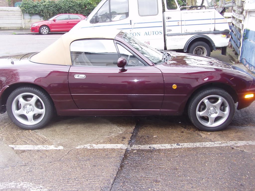

 Here’s a ‘Before’ –
Resized to 85% (was 1024 x 768) - Click image to enlargePosted Image
Here's an 'After' --

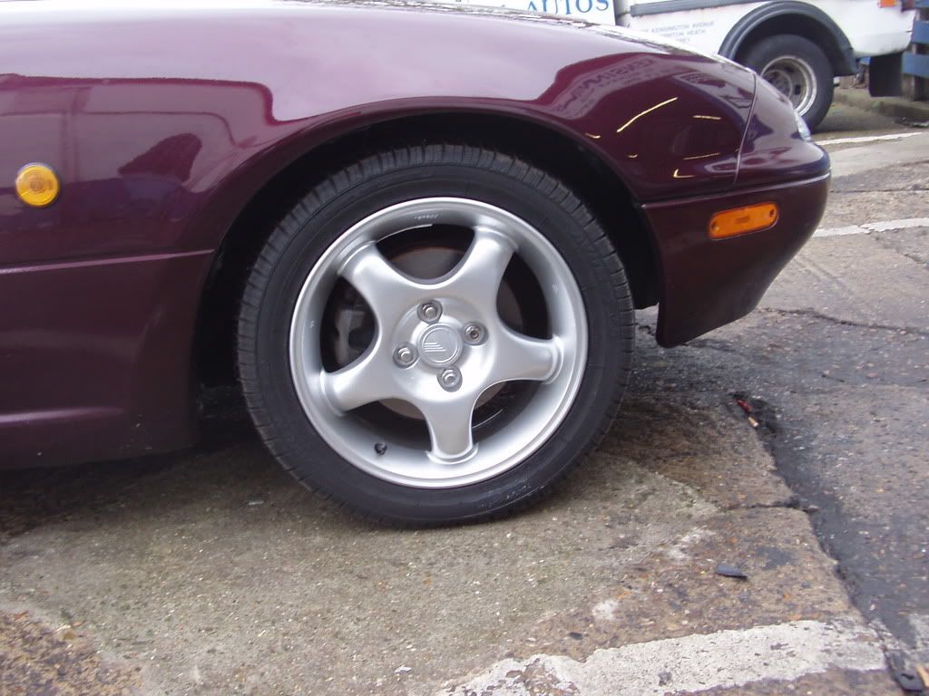

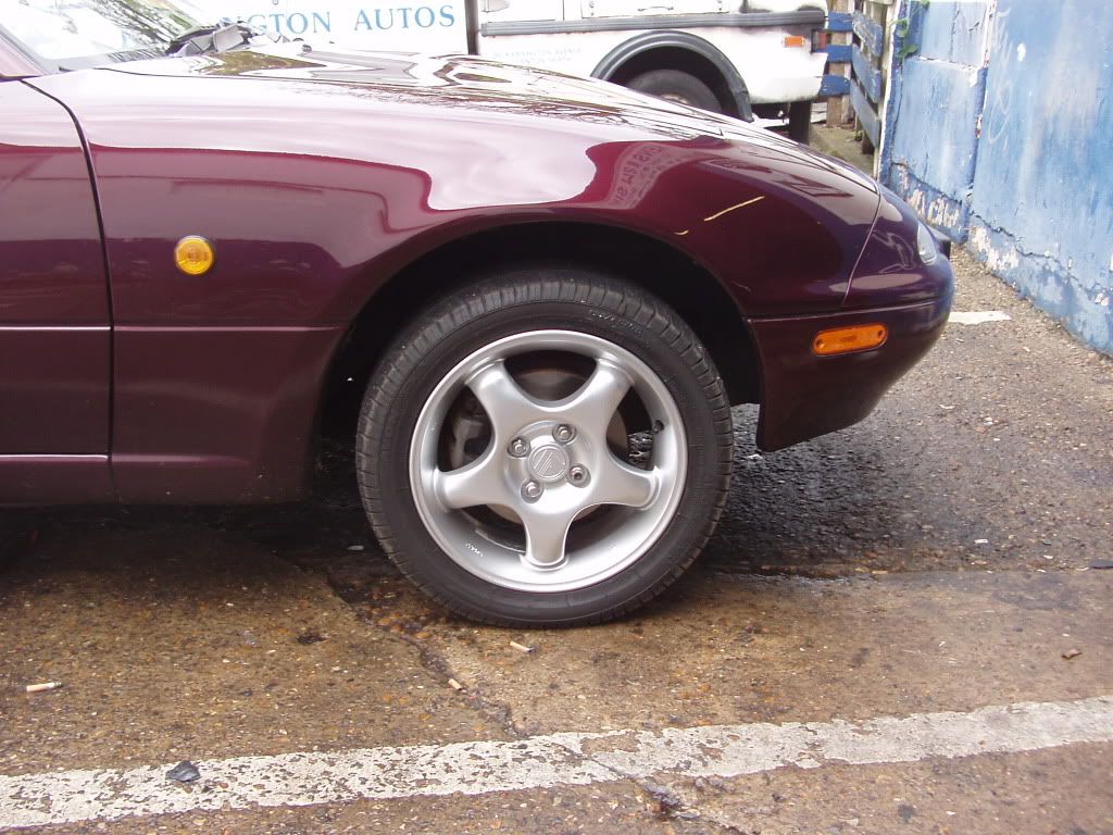

Another 'Before' --
Another 'After' --

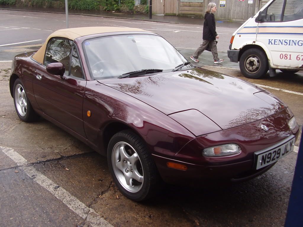

..........and another 'Before' --
..........and the last 'After' --

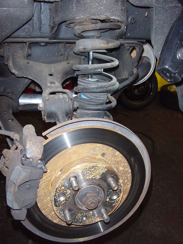

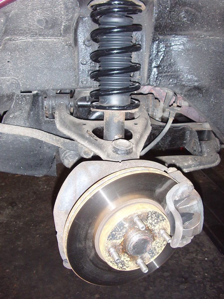

The use of the ....err... angle Grinder ? Simple really, as I said, strictly non pc (the health & safety police would have a field day) but damned effective --->
Posted Image
And the finished article --->
Posted Image
O.K. so one pics the back and the other's the front but the principle worked all round.
Job completed on the ramps at my Son's garage (or rather the Garage he does all the work in) with the aid of a very large persuading lever and said angle grinder. - Simples ! :yes:

“Well, the new springs are in and I have to say that I’m comfortably well pleased with the result. Nicely lowered but not too far that those damned ‘speed’ humps become an embarrasment. :rolleyes:
Must say that the ride quality has improved to my mind too. Seems to be more comfortable and a there’s a noticably bit less crashing around. Only fitted (a demon method involving the use of an angle grinder :whistle: - don’t try this at home kids) and set-up on Tuesday so I’ll know even more when it eventually stops bl**dy raining and I can get out for more than a traffic full bimble.
Full marks to Autolink, great advice and money well spent.” :worship:

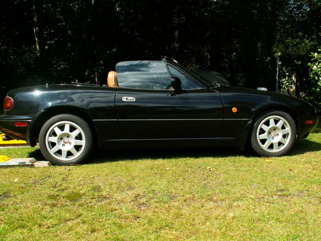

 The front of my V spec was ok but the back like yours rather high. I fitted a pair of Autolink spring to the rear and it sat lovely, but wifey thought it rather too firm so I changed them back. I think the springs are probably fine and it is more likely my shocks are a bit long in the tooth. So I will have to get some replacements sometime and get the Autolink sport springs back on.
Before
After
