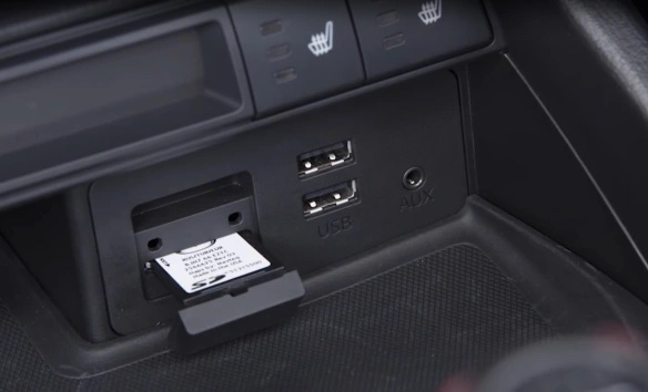

What is the square / oblong cover / block next to the USB ports for in a 2018 ND? I can’t find any reference in the manual either.
It’s the cover for the satnav card
That is where the SD card lives, it has the sat nav data on. When you want to update the maps you have to remove it and use a PC to transfer the latest map data to it.

It can be very stiff to pop open, I didn’t want to force it the first time I tried.
It opens from the top and the SD card is removed by pressing it in
