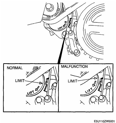

Your post suggests the alternator might actually the one squeaking, because immediately after a cold start it asks for maximum drive power. However this is unlikely because the tensioner is automatic and self-adjusts to prevent a slack belt - the usual cause of a squeak. This pic is from the usual Mellens service sheets.

If a bearing is on its way out, eg alternator, idler, etc, then the simple way to check without running the engine is remove the Auxiliary belt by relieving the tensioner with a suitable long spanner. (But first take a pic of how it was routed, for future reference.)
Then spin each pulley by hand, they should all be free and easy and SILENT, no rumbles, grumbles or clicks, and definitely no wobble or play.
The engine can be run briefly; and if the noise is absent, then it was one of those components driven by the belt.
